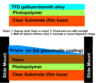

I have been studying holography recently, and I learned of photopolymer film. It self develops itself! All it needs is an exposure, and then intense light. With the materials currently available, you could make Lippmann photographs in a regular 35mm camera. If someone else was into Thin Film Deposition and could deposit an alloy of gallium-bismuth that would melt off at around 110-120F , then the ISO would be doubled and the resulting Lippmann would be super colorful.
Though Lippmann is quite low iso, I bet a high iso photopolymer film in 35mm would be crazy. I think Big Film hasn't done this because they would loose the developing market. Photopolymer is way more costly though, but I assume thats more due to its highly specialized use case currently. What do you think?

Im pretty sure more than just retro junkies would like to take pictures on this stuff. Lippmann photography is *the* best color recording medium to exist today. It literally copies the wavelength of the real object directly. Im pretty sure everyone would be shooting on this stuff if they had access to it. It can copy so accurate of an image of reality that not even your computer screen can display fully.
Can that concept be prototyped by a mere mortal?
it already exists and you can buy it too. Its only been used in what we would consider large format. Unfortunately nobody has bothered to cut and pref to 35mm. It would probably need some sort of substrate (not sure if its included)
my idea: you would expose it substrate first. I am not particularly sure how fragile the photopolymer is. If it can stand normal film development temp, then you should be able to melt off the alloy reflector. The reflector is not needed to make Lippmann photographs, but it would increase the speed a lot.
Photopolymerisation films, self-developing or to be developed, need an imaging exposure with strong light. Either with a Laser or with UV-light. Thus they are hardly applicable for taking a photograph.
However, to divide imaging exposure from polymerisation exposure is the way to go indeed.
