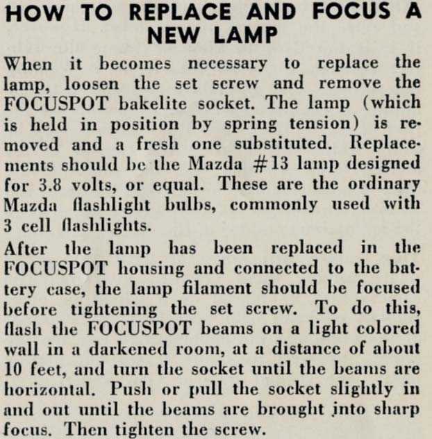

Kalart Focuspot:
Graflex Graphic Rangelite: part number 34953 Lamp, 2 1/4 V, 1/4 amp (replaces p/n 25794) Qty. 1.
Now you know what the originals are.
