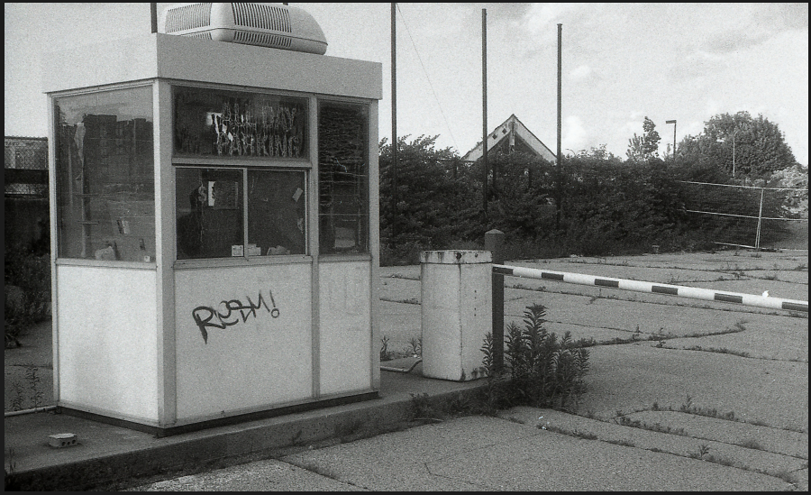

Thanks for the sample. Indeed, it looks like a Rodinal development.
