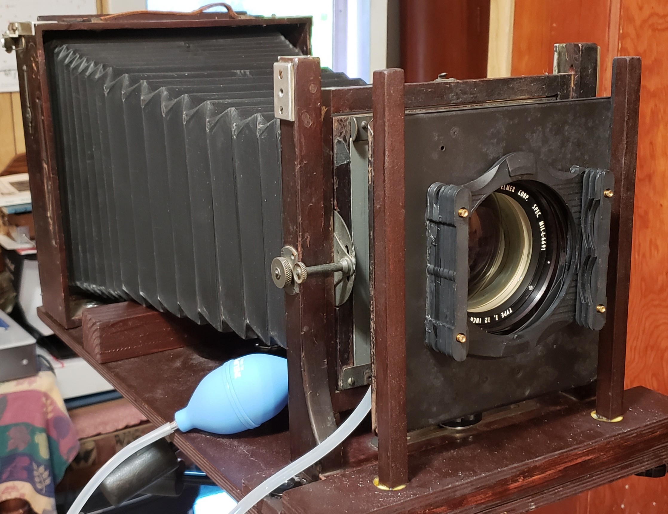

I built an 8x10, fixed-focus, fixed-aperture (wide-open) camera with a Packard shutter.
It was a pitiful husk when I got it, and I had parts-a-plenty, a little creativity, and some woodworking skills...so why not? 🤓
And it just so happens, I shot film with it for the first time yesterday. 👍

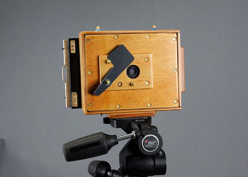

I've almost done the camera wished for, it's what Matt King suggested -- a 4x5 pinhole. One could replace the flap shutter and pinhole clamp with a lens and adjust the registration dimension to some sort of hyperfocal distance and you're there. But cheeze, to do that much work, far better to use a shutter mounted lens, offering shutter speed and aperture. And then, I personally would far prefer some sort of focus capability. I mean, how much trouble is it to make an adjustment or two?!
