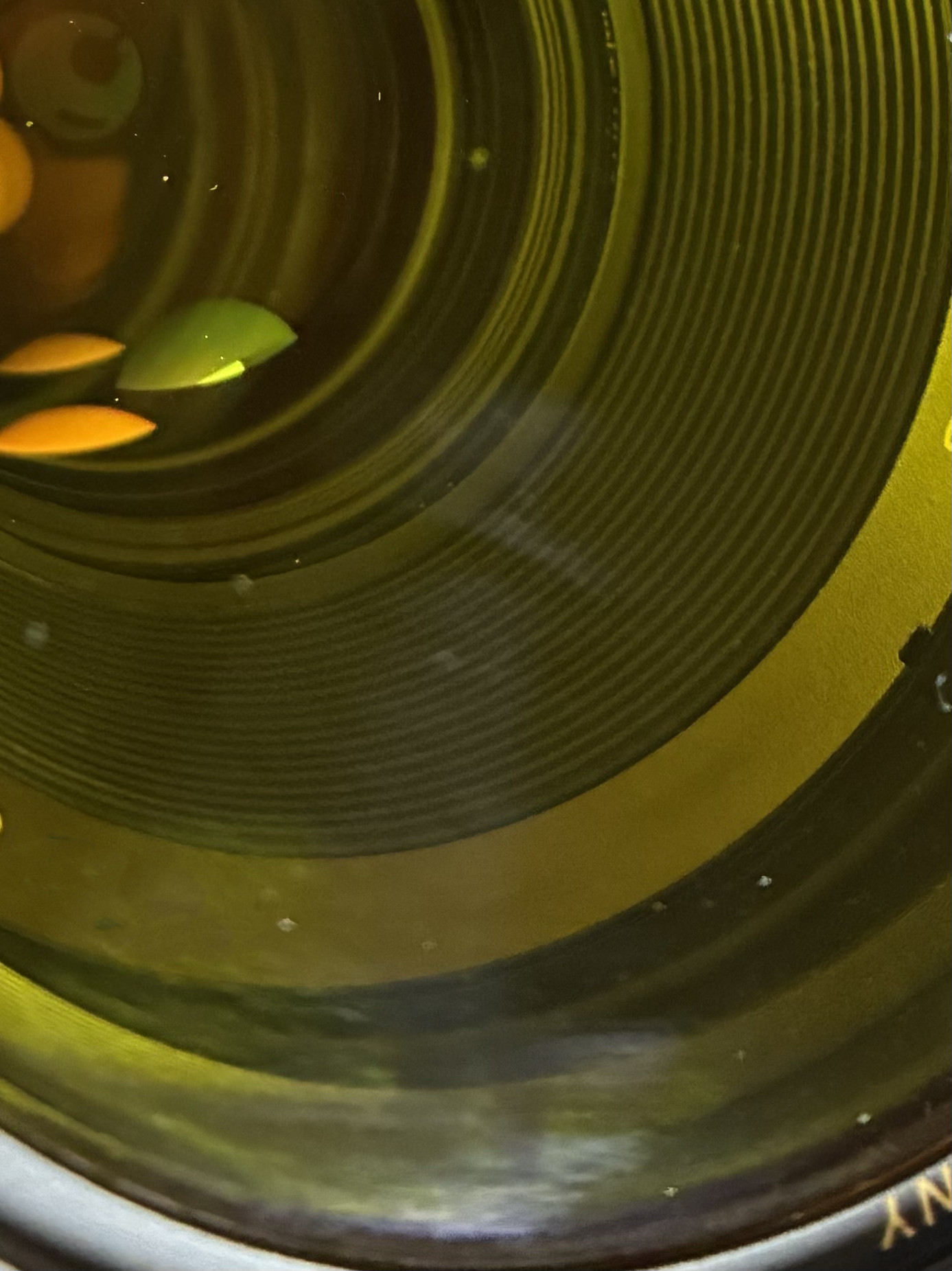

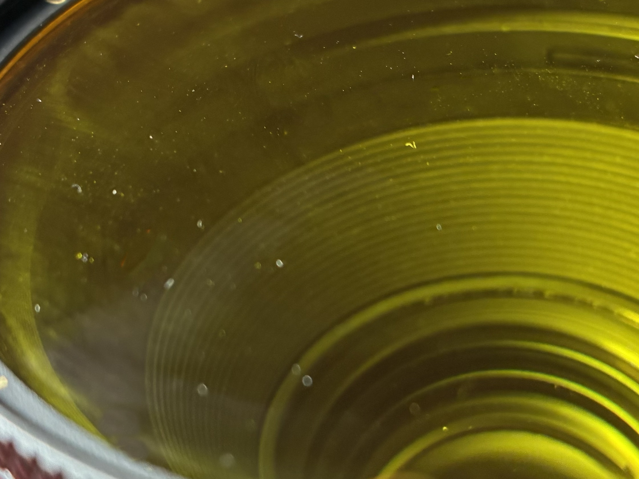

Do you use ROR fluid on your B+W MRC filters without any issues?
Some grease found its way onto my B+W MRC Yellow filter. I sprayed a liberal dose of ROR fluid onto it, gently rubbed it in a circular motion with a clean microfiber cloth, and watched in horror as the filter developed a greasy haze on its surface that would not go away. Also, some of the filter's coating looks spotty or less yellow now.
The grease could be cooking oil. I think a wayward or curious finger touched the filter's surface during the holidays. I am thankful the same grease is not on the lens.
This is difficult to show in photographs:

I use a clean cotton undershirt, apply the ROR to the cloth. Then clean your optic. You have liberated assembly oil from the internal threads of the filter. Be careful to use least amount. You shouldn't have trouble cleaning up your filter, those are the best and most durable.
ROR ingrediants:
  • ammonia
  • sodium chloride (essentially table salt)
  • Isopropyl alcohol
  • liquid soap
  • distilled water
in short, No
Depending on the oil type, you might use a specific solvent to dissolve it initially. Fat and skin oils, alcohol. Petroleum based oil, naphtha. After this, then do a final cleaning with something like ROR.
filters can indeed bedamaged by cleaning fluids,especially those which are manufactured by sandwiching a coloredgelatin layerbetween two sheets of glas. The capillary action will allow the fluid to come into contact with the gelatin and harm it. the multicoated glas surfaces,on the other hand, are not sensitive to optical cleaning fluids. Having said that, your technique may need improvement. Never spray cleaning fluid directly on lenses or filters! Use a clean cotton rag andpray a little cleaning fluid on that and then clean the filter or lens with that!
The Zeiss lens tissues work well for final touches on filters.
ROR won’t do damage - especially to the MRC coating.

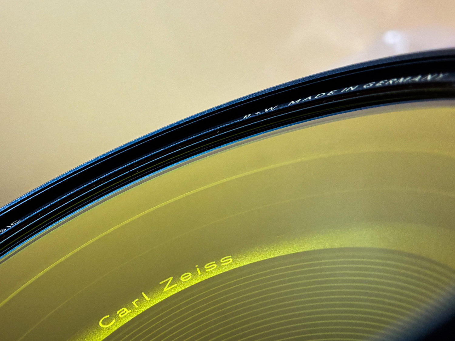

Thanks everyone. Dan's response was the solution here:
I rubbed 70% isopropyl first aid antiseptic alcohol on the filter's surfaces with a Kimtech wipe. Then I rubbed ROR fluid on each surface with a fresh Kimtech wipe after that.
It looks much better. I do not see grease tracks anymore no matter what angle I view the lens filter from. I do not feel bold enough to try putting 70% alcohol on my lens' surface, though. The white/light patch you see is just a reflection of a lamp.
