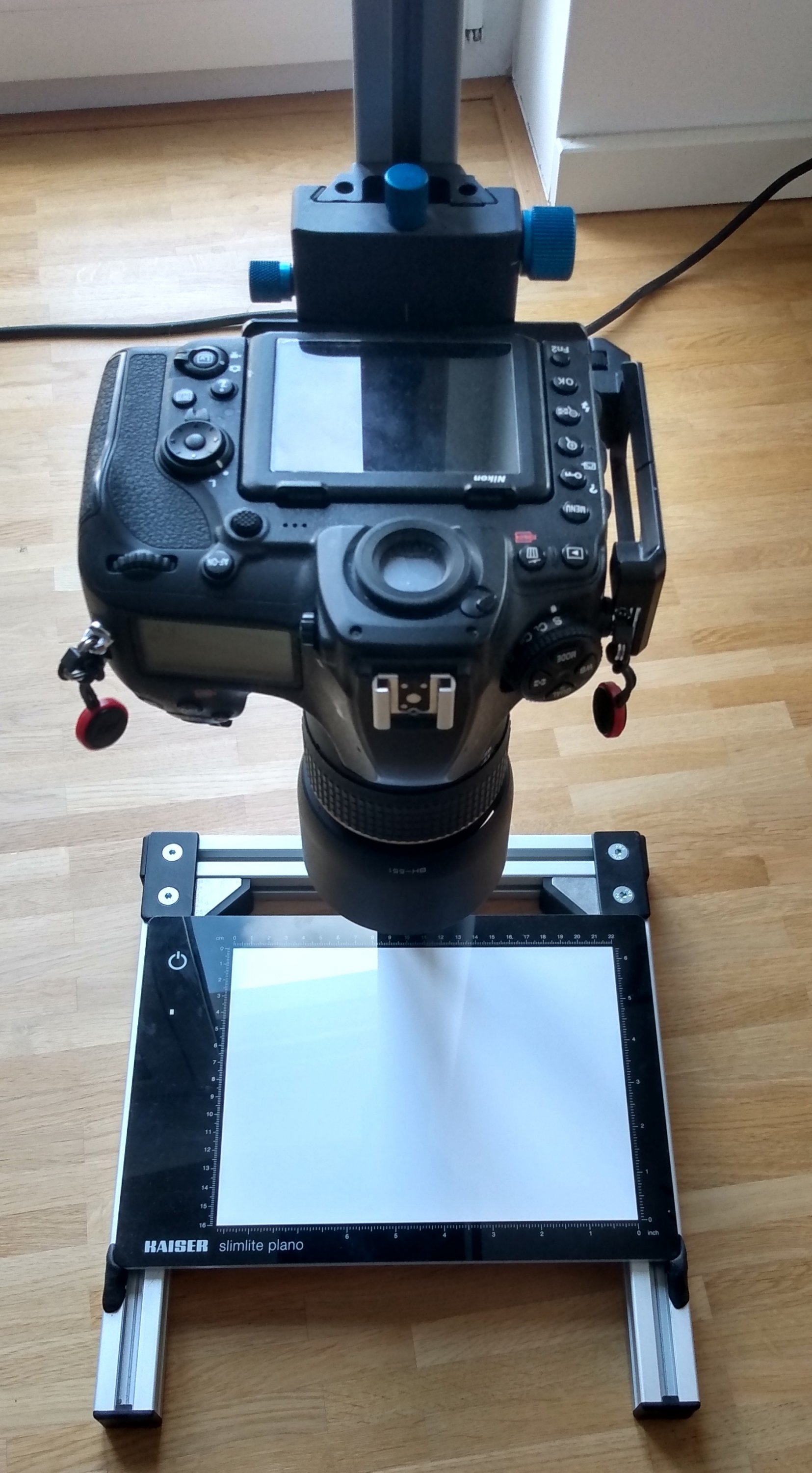

My current workflow is as follows:
  1. Cut negatives into strips of 2 for 6x9 or strips of 3 for 6x6
  2. Place negatives in Lomography film holder
  3. Remove dust with air blower (and sometimes a brush)
  4. Place negative holder on Kaiser light table at full brightness
  5. Set up Nikon D850 + Tamron 100mm Macro on scanning stand (i use this cheap one: https://www.dold-mechatronik.de/Reprostativ-V5-kit)
  6. Dial in Settings, snap the image and double check exposure, removing dust again in between images
  7. Repeat until all image strips are scanned
  8. Load into Lightroom --> wish I could use teathered shooting, by my Lightroom version (6) does not support the D850
  9. Quick, almost automated edit with the Negative Lab Pro Plugin
A roll of 120 film takes me about 15 mins I'd say, but there's definitely room for improvement. Once I have finished my new film holder I will probably make a full detailed write-up of the process.
