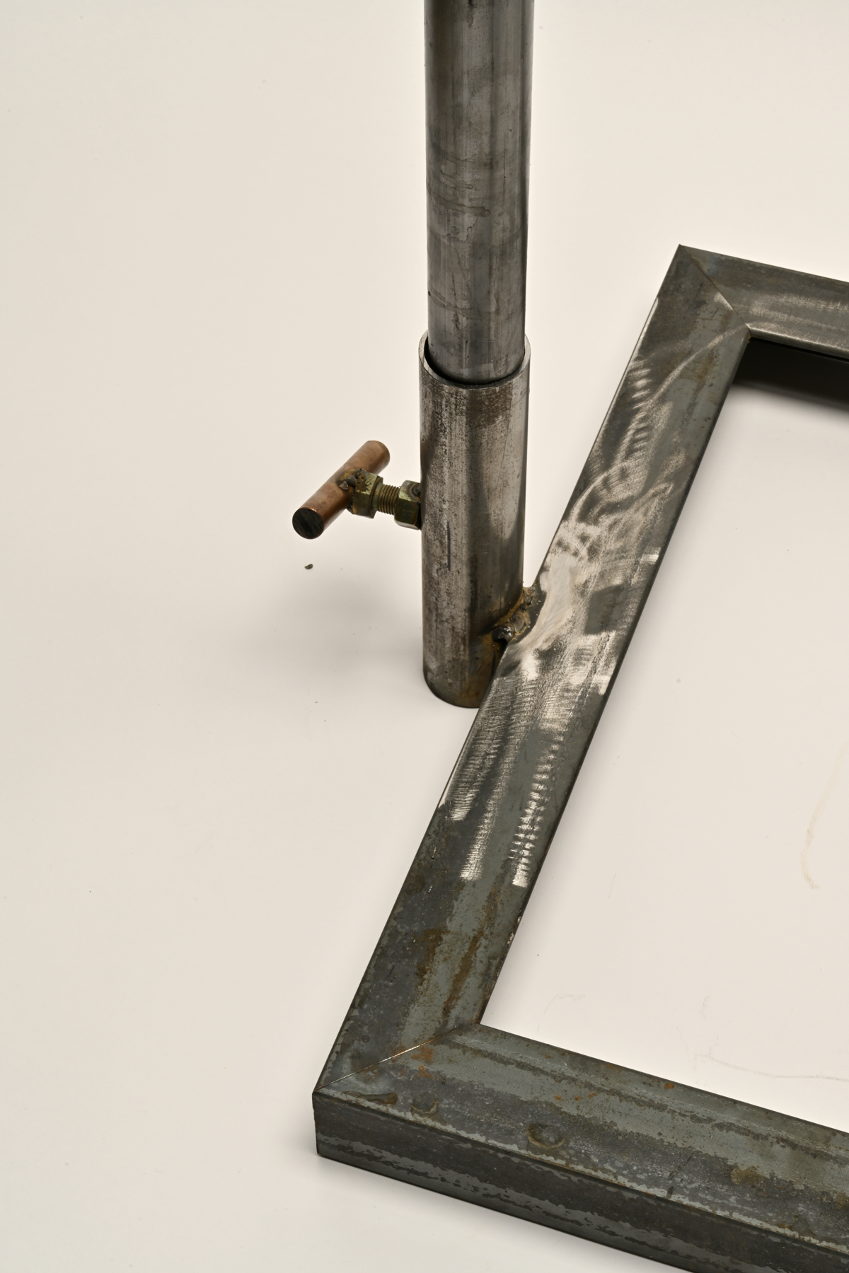

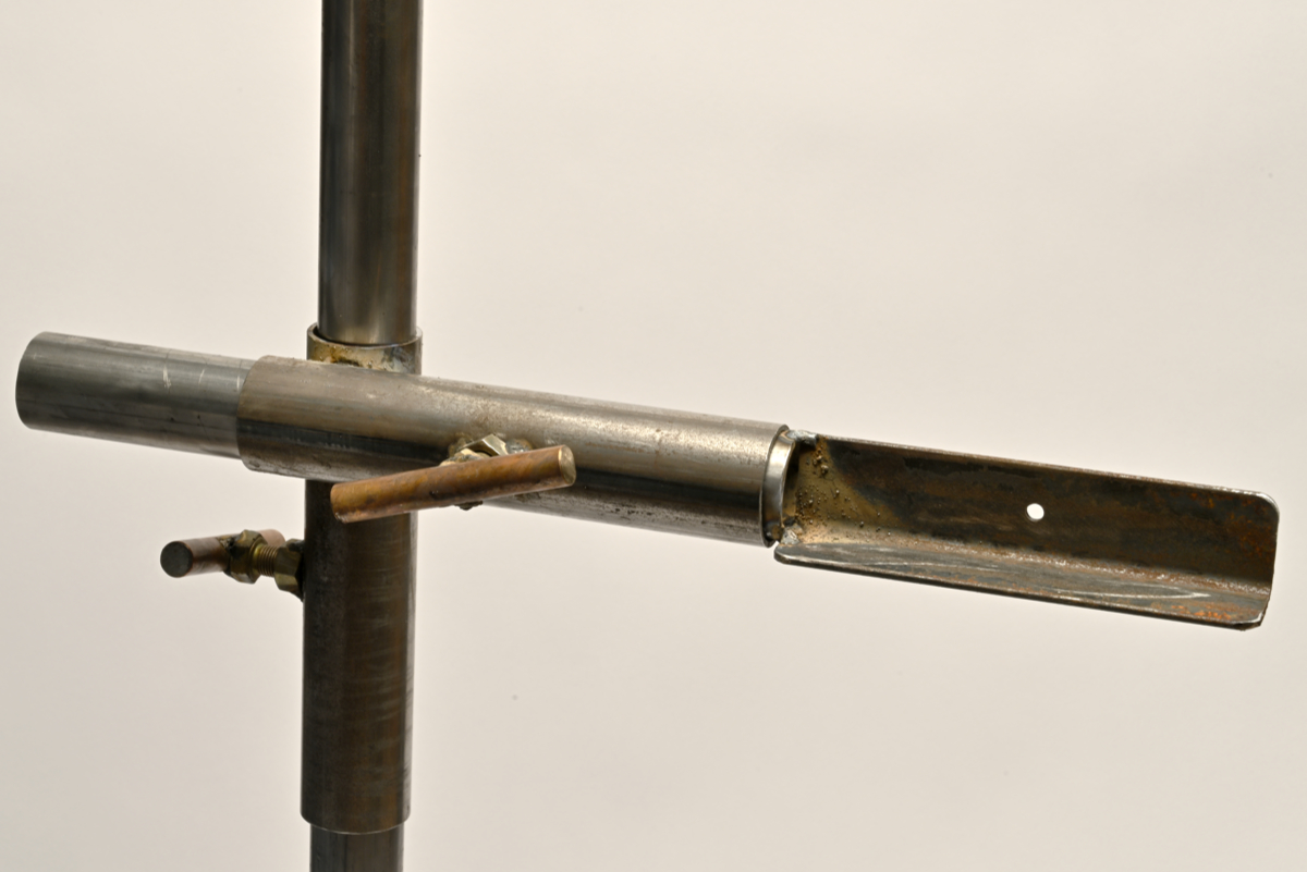

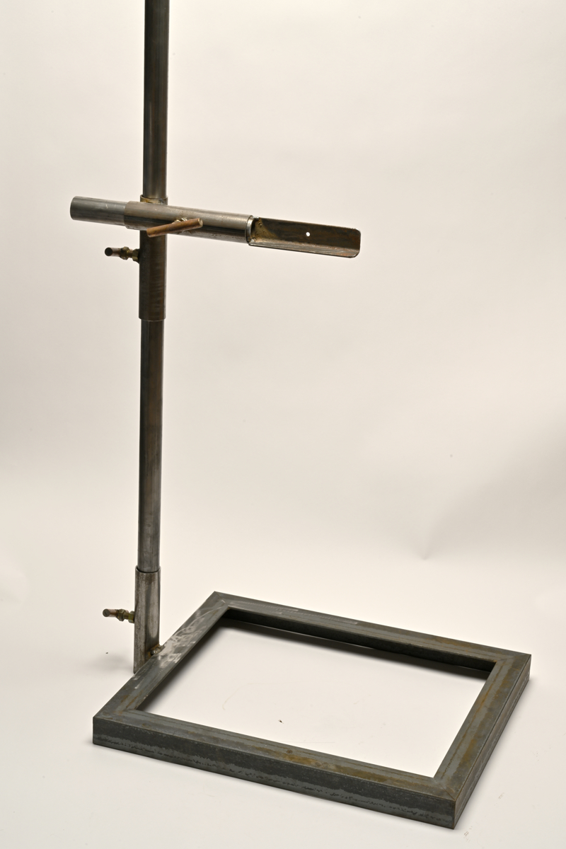

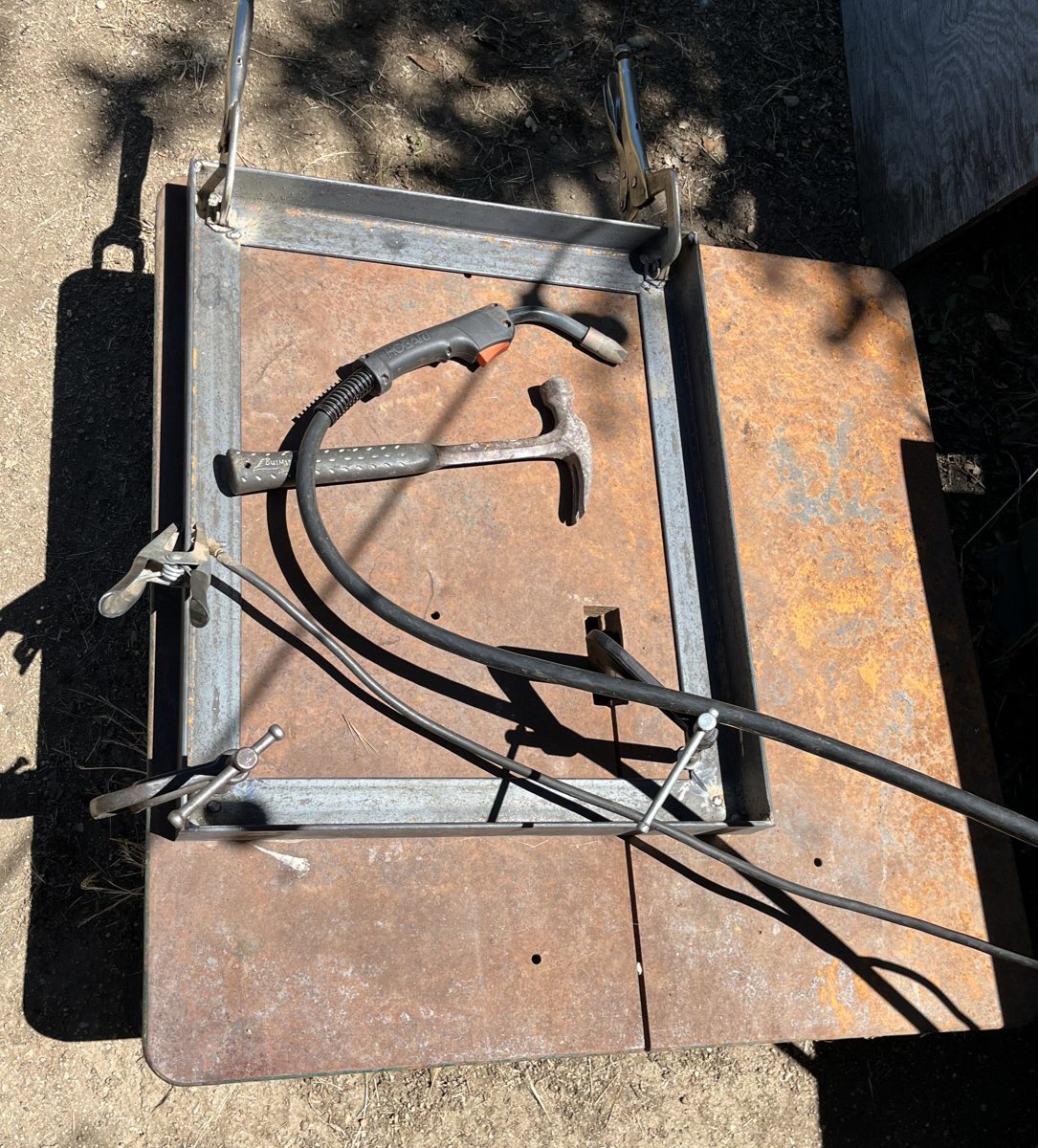

The Steel is finished and I am looking for high pressure laminate for the copyboard. I want to put a transparency/negative illuminator window in the center of the copyboard. The angle iron base is 2" x 3/16". The mast is 1.5" x 1/8" steel tube 5 feet tall. The clamp tube is 1.75" x 1/8" but must be thinner as there is .050" clearance between the 2. (Check with your local steel seller.) The camera bracket is 1.5" x 1/8" angle iron. It was welded with a Hobart 140 Amp Handler MIG welder, flux core/no gas. The bolts are 1/2x20 with 5/8 rod welded across the head. I used fine thread for better clamp force. Oh, the base is 20x24".
Welding anything flat and square is tricky. Clamp everything and tack, tack, tack as welds shrink when they cool pulling things out of alignment. Once the structure is ridgid you can increase the size of the welds.
I spent about $40 on steel and $14 on bolts because they were grade 8 from Ace and less expensive bolts would have cost more in Diesel.
Still deciding if I want built in light holders or use light stands.

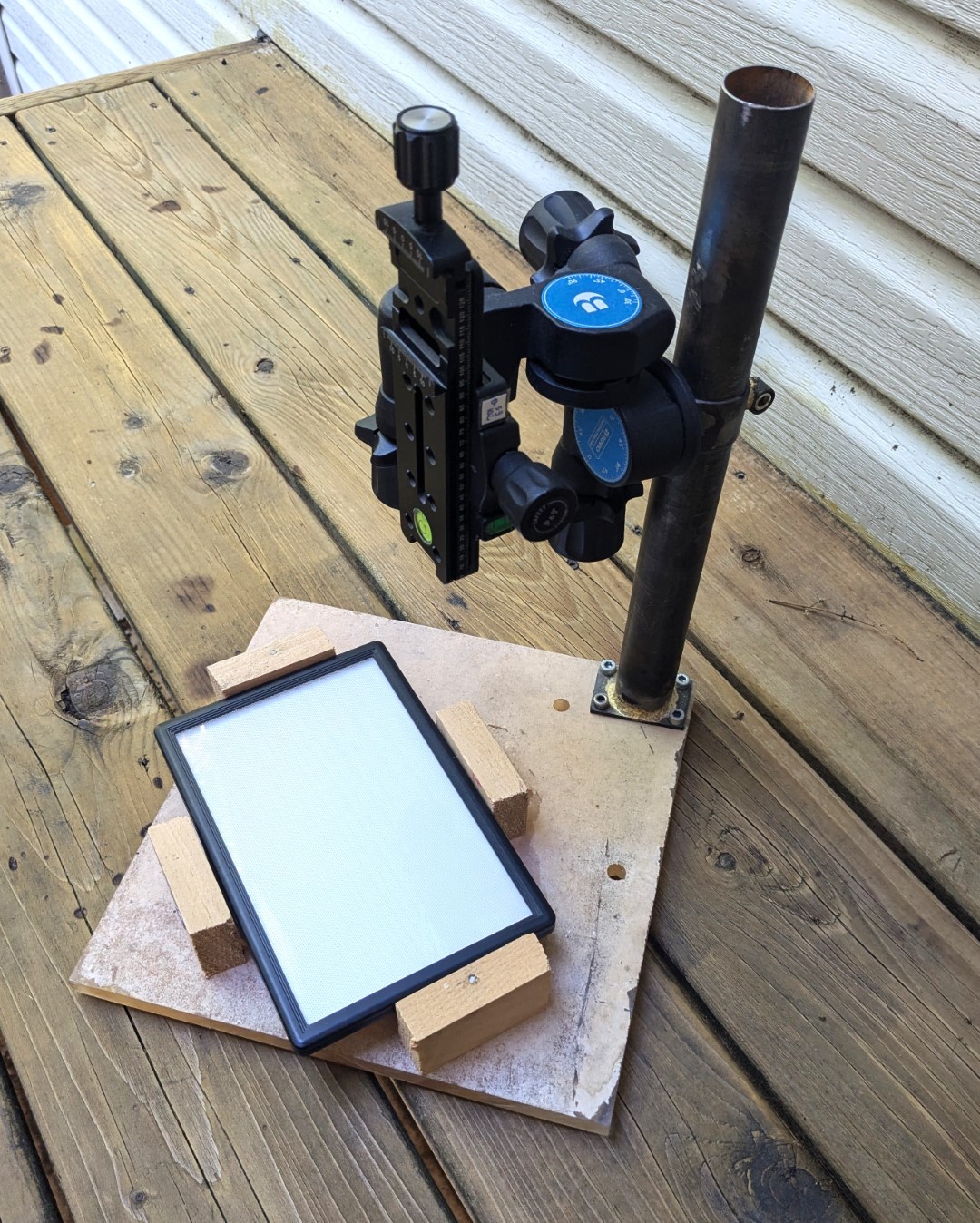

Here's my DIY copy stand for digitizing film. Thick acrylic base, steel post with brazed attachment plate and telescoping collar, geared tripod head with nodal slide.
I'll bet that geared head is handy for close work!
This was standard teaching when I learned to weld in 1975. Does no harm to reiterate, though.

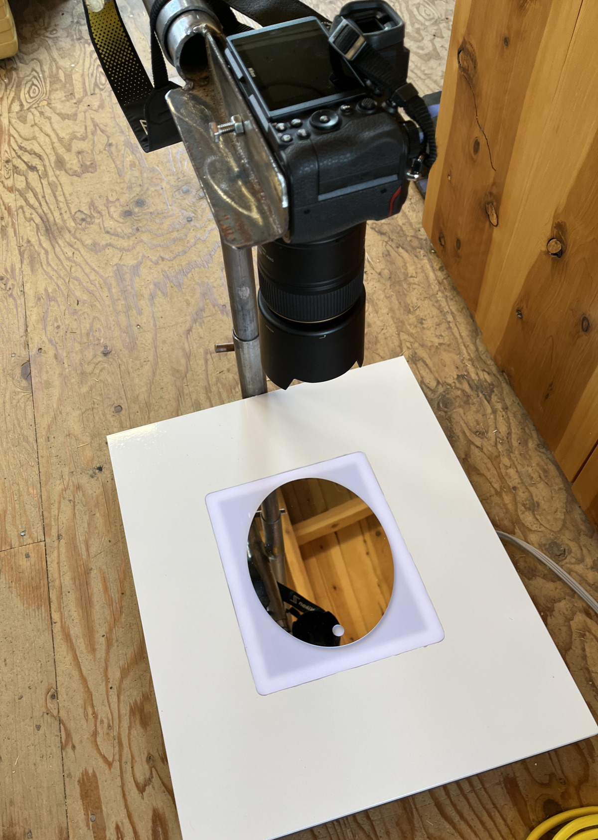

I found a particle board shelf at my local ReStore and although I detest the material it's hard to beat $1.67. I cut a hole, routed a recess and painted it to seal it. This morning I dropped in the plexiglass and slipped a flat panel LED light underneath.

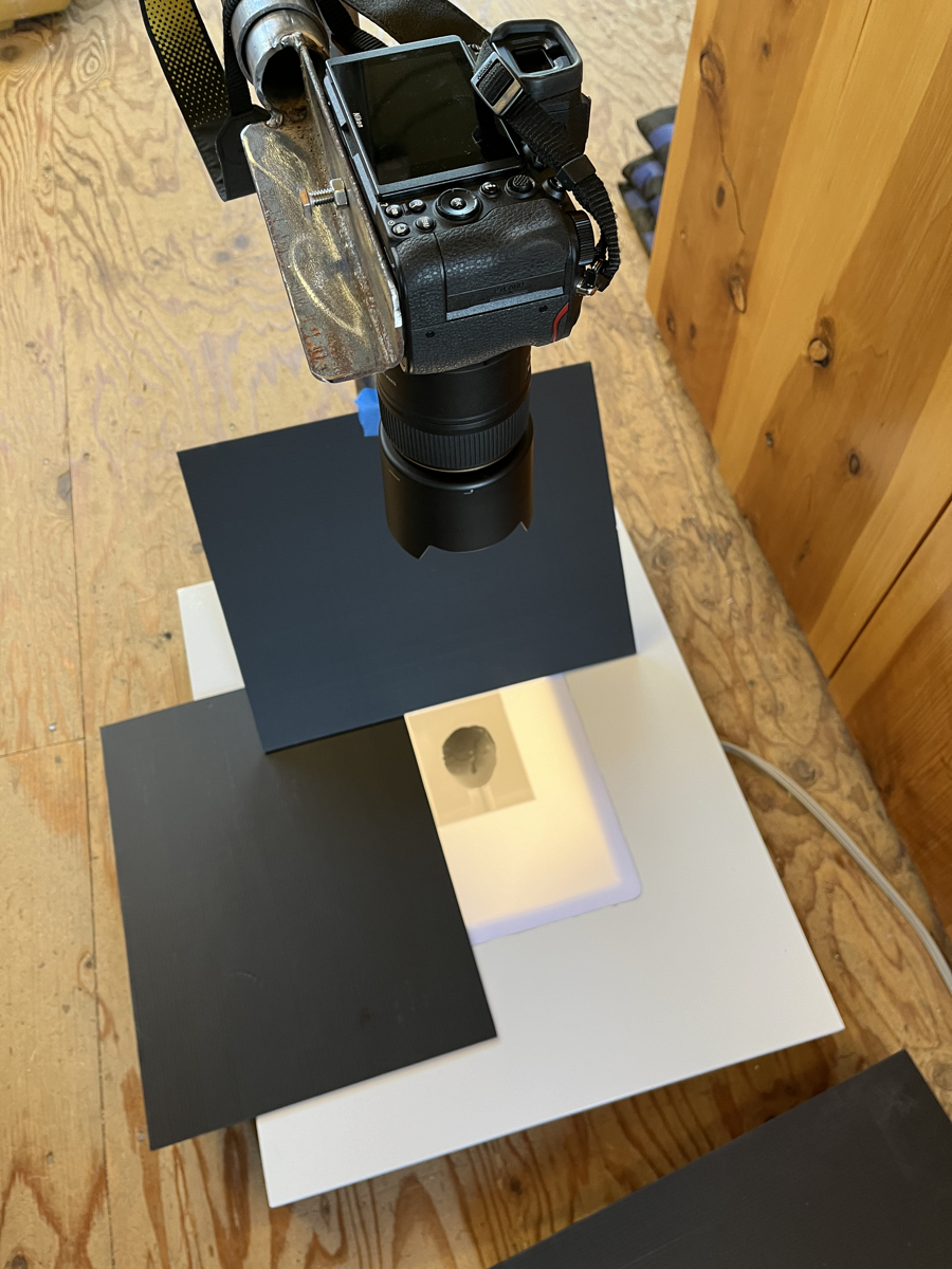

I removed 2 of the black boards to show the plexiglass better. The camera is a Nikon Z7ii with an afs 105 macro.
The only welding photo I took. My neighbor thinks I should have done a "build video" but that takes time away from the build. lol
Oh ya, a mirror really saves time aligning the camera, shower mirror from amazon.

As detestable as particle board is, it's hard to get something flatter or more dimensionally stable. You copy stand is looking great.
