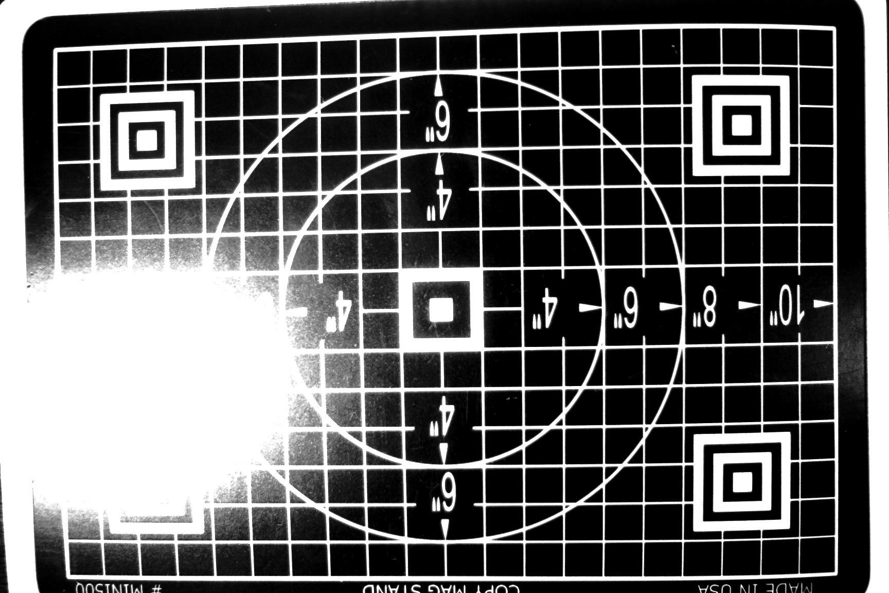

went with 8 mins in D-76 stock, still managed to extract a small amount of grey tones. Pretty happy with the results overall though my lighting was a bit off:
