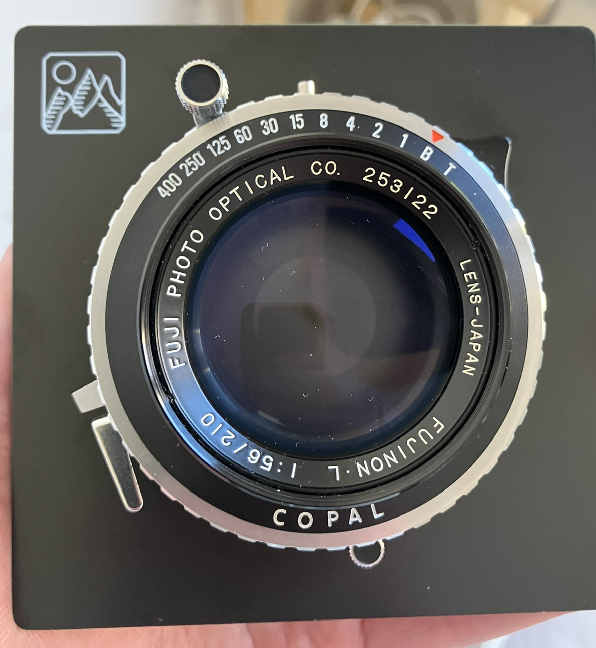

I have a Fuji 210mm f/5.6 in a Copal 1 shutter. I was shooting today when the ring for selecting shutter speed got ”declicked”. Before it had distinct clicks or stops between every shutter speed setting but now it moves smoothly over all shutter speeds.
All shutter speeds working without problem, the problem is the shutter got ”declicked”.
Anyone here have any idea what might have brooken and if it is a easy DIY fix?

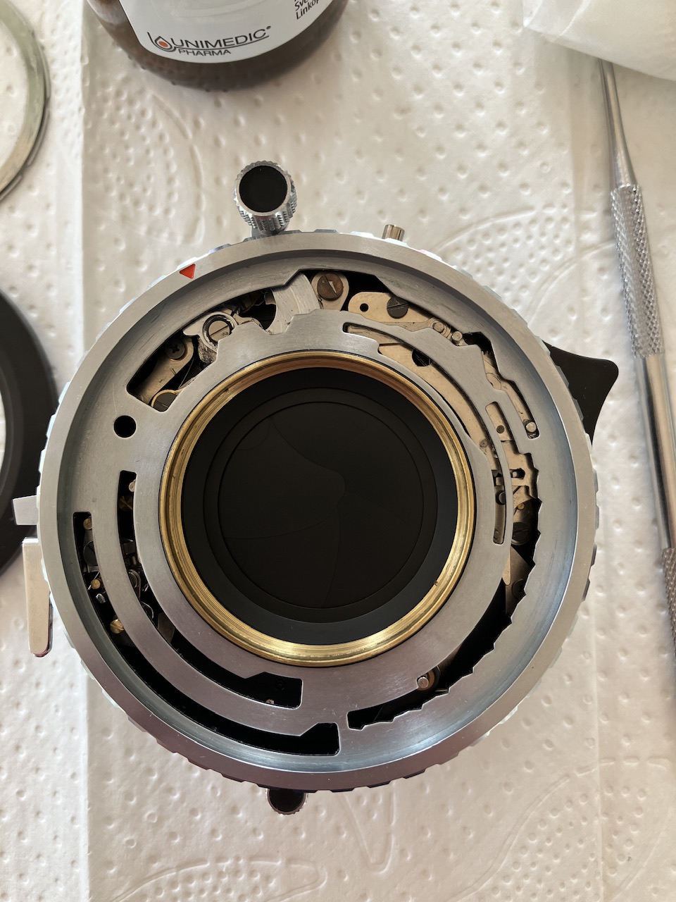

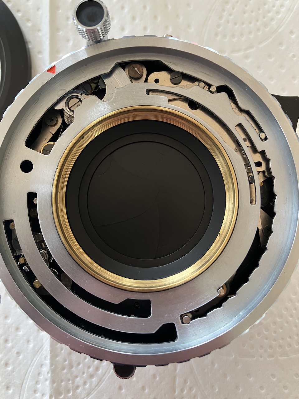

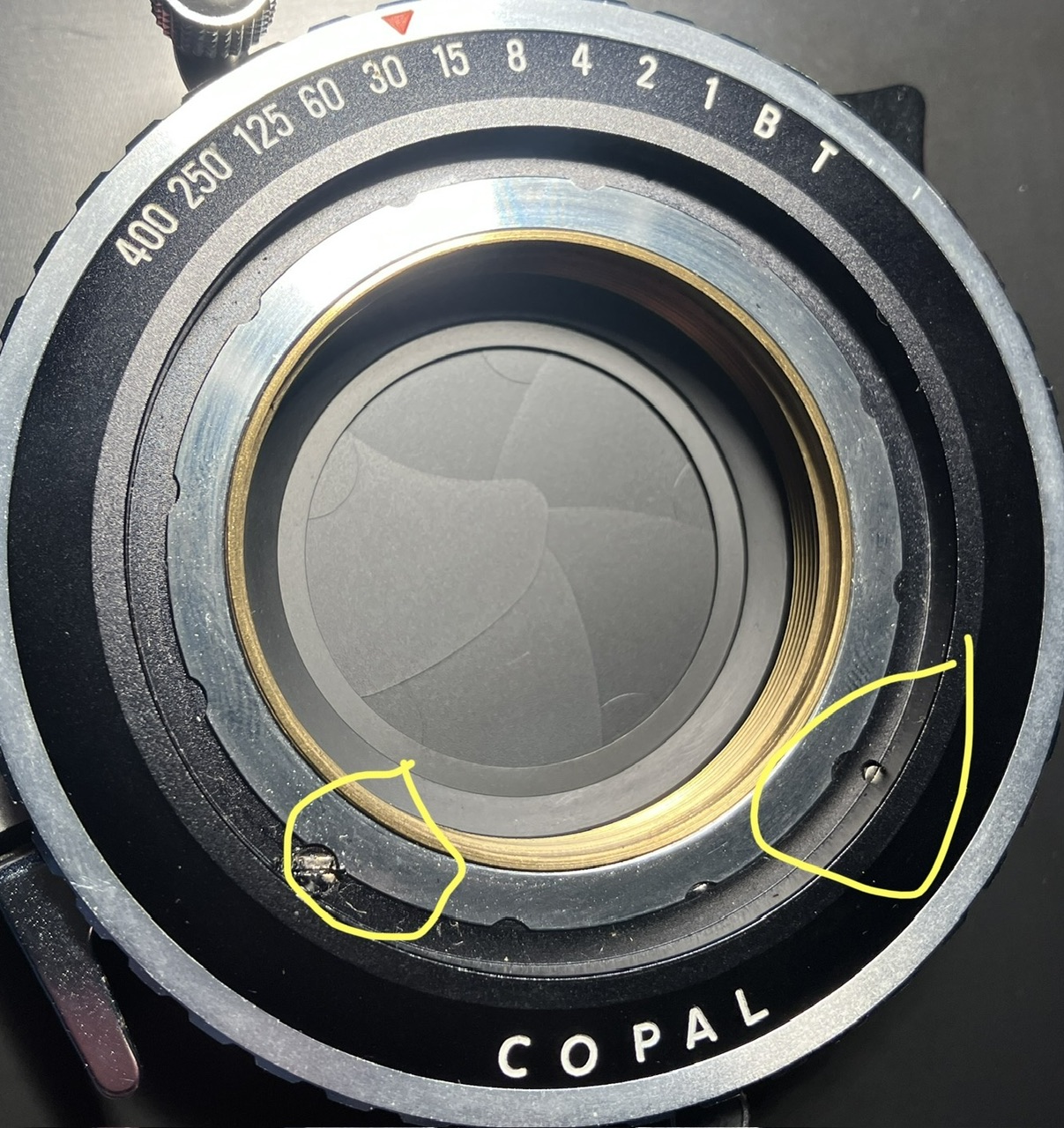

I see two screws when removing the front lens cell, one is locked with screw locking lacquer. Which of the screws holds the front plate?
OAPOli
Sep 26, 2022
804
Toronto
The screw with the lacquer holds the notched retaining ring. The other is not a screw but a pin to properly locate front plate when you put it back.
You can mark the retaining ring where it meets the locking screw to put it back at the same spot. It's not overly critical but the ring should not be too loose: it preloads the speed setting cam.
If you need to remove the speed setting cam pay good attention on how it is placed. It's pretty straightforward but it needs to properly catch a few pins in the inside mechanism.

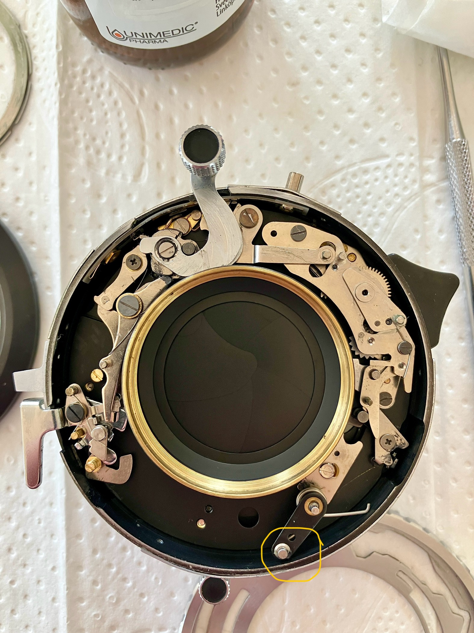

Finally had time to fix the issue🙂
Not shure what it is called but it act like a cam shaft when the shutter speed setting ring is turned. I did a marking in the photo so you all can see what I am talking about. This pin had come loose because the shutter speed setting ring was not tightened enough.
It was a simple fix.
