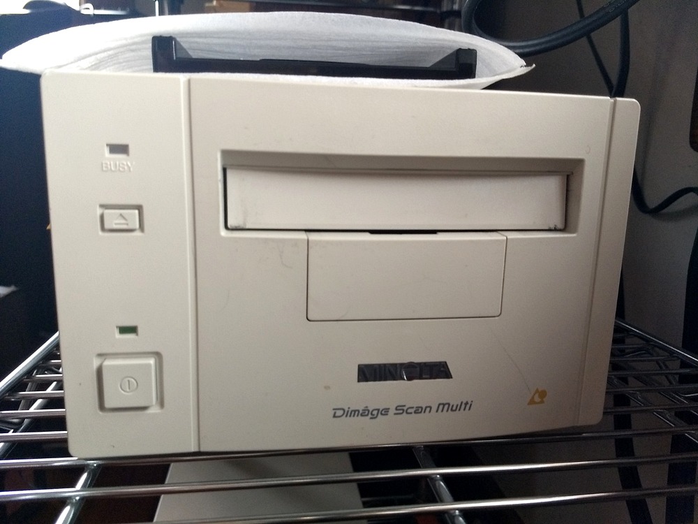

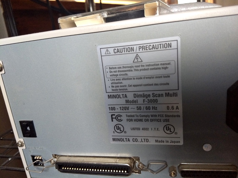

Apparently there are many variations of "Minolta Dimage Scan Multi". This site states "2820 dpi resolution (32.5 meg file from 35mm neg), 1128 dpi for medium-format scans" -> https://www.imaging-resource.com/PRODS/DSM/DSMA.HTM
yes, I've seen that there's three versions . Scan Multi , Scan Multi II (which seems that it only has a software update) and Scan Multi Pro. Right now I'm been offered the Scan Multi and I'm not sure how easy would be to get the software update these days.
WRONG! Les, let it go. You stated that you don't own a Minolta. White about the scanner that you use. As I wrote above, I HAVE A SCAN MULTI F-3000. The label on the machine clearly states that. The Scan Multi II is model F-3100, a different machine. I regularly scan 6x6 frames at 2820 dpi on both of my F-3000 units. I clearly stated that above. The gent who asked the original question wants real and useful information.
View attachment 267855 View attachment 267856 View attachment 267857 View attachment 267858
The resolution specs listed on the mfg website for the Multi I and your Multi seem to be as I already listed -> https://www.konicaminoltasupport.com/index.php?id=3088&L=2641
Since I nor the OP and possibly others who may be interested, don't have this scanner and you do, you can clarify this discrepancy.
WRONG! Les, let it go. You stated that you don't own a Minolta. Write about the scanner that you use. As I wrote above, I HAVE A SCAN MULTI F-3000. The label on the machine clearly states that. The Scan Multi II is model F-3100, a different machine. I regularly scan 6x6 frames at 2820 dpi on both of my F-3000 units. I clearly stated that above. The gent who asked the original question wants real and useful information.
