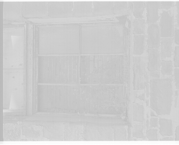

I developed a roll of 120 T Max 400 today and started scanning it. First strip of negatives worked as usual and I ejected the film holder and put in the next strip. The previews are all striated and have random colours ( although it's set to greyscale and neg (mono) in the scan setting). The scan below is what I'm getting from the scanner.
Any ideas what happened? It's a massive loss of contrast and density compared to normal. The odd thing ( to me) is I didn't change any settings from one negative strip to another.
Scanner is a Nikon Coolscan 9000 using the Nikon Scan 4.0 software. Any ideas what might have happened?
Turn off Digital ICE. It is not compatible with traditional BW film, and the results you got are what the scanner gives with Digital ICE on with BW film.

That worked! Thank you! I never knew that ICE didn't work with conventional B&W film until now.
