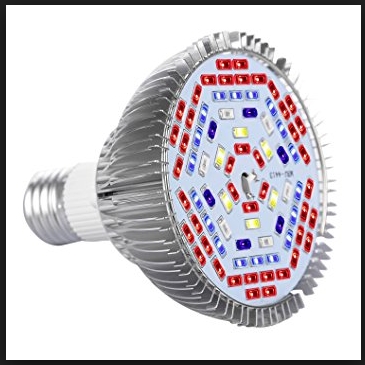

Since this is a condenser enlarger, it projects the image of the top of the lamp. Look at ways you can get a nice uniform surface, may need a piece of uniform diffusion between the lamp and the first condenser.
For example this would not work:
