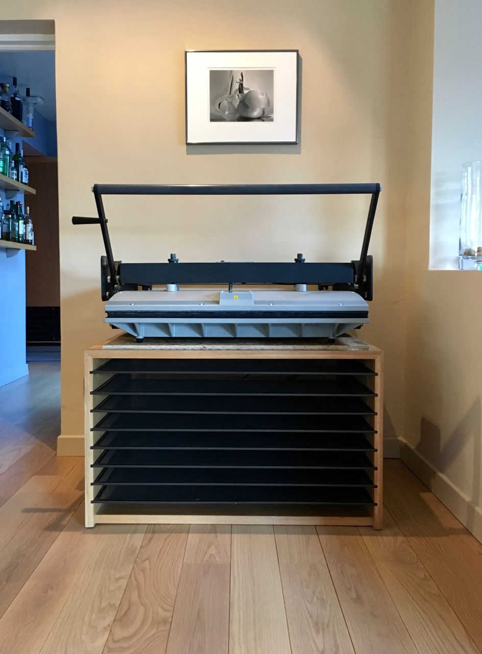

In any case, I am happy to let you all know that I have resolved the issue by buying an unused, still-crated, Masterpiece 550 230V. It is rather huge, but works very well, with far more pressure than I got from my previous two presses, the Seal 210 and a Bogen 500.
