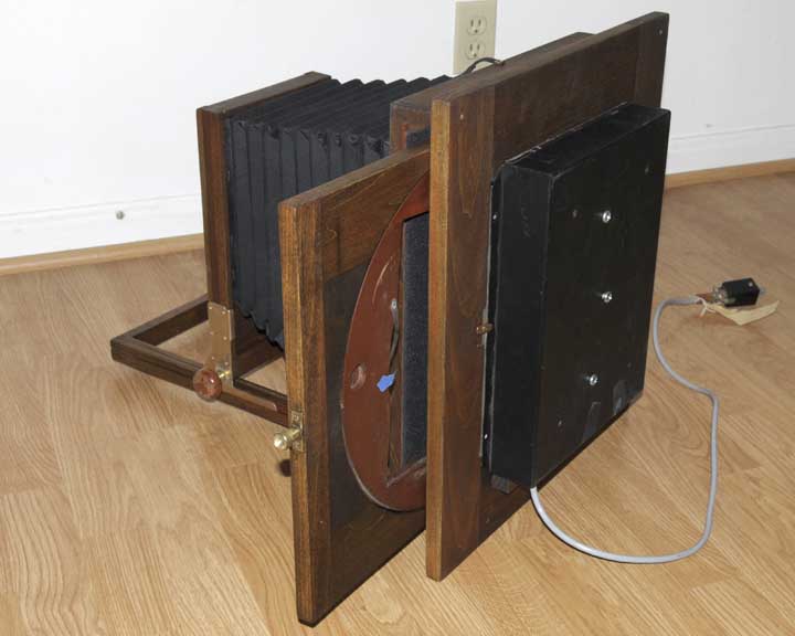

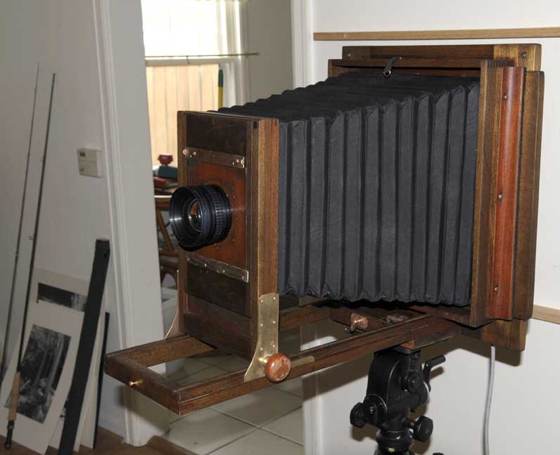

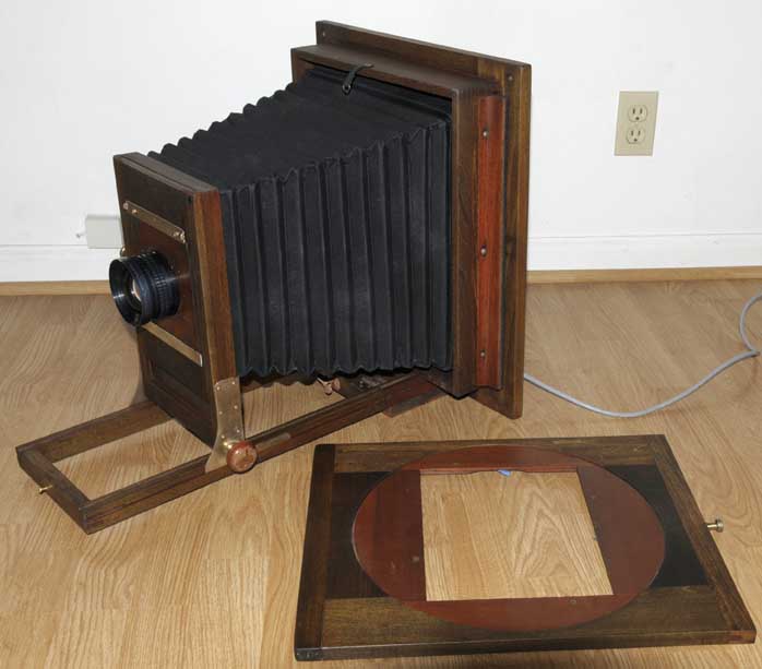

Just this past weekend I built a new set of bellows and stripped and old 8x10 horizontal enlarger and danish oiled the heck out of it. I haven't used it yet as I have to fabricate a vertical easel to use. I grafted a cold light head onto it and it will project through a 240 lens a 40x50 inch size from an estimated 5 to 7 feet away from the wall. It is a lot brighter than I expected it to be so I don't think the exposure will be overly long? The hardest part will be aligning it to the easel I think. The thing I like is it is portable and stashable for my limited space. Does anyone know what type of cc filter I would need to use to correct a w31 cold light to make it useable for vc paper. I don't want to purchase a v54 bulb in this size for monetary reasons:smile: anyway, here's a couple pics.
