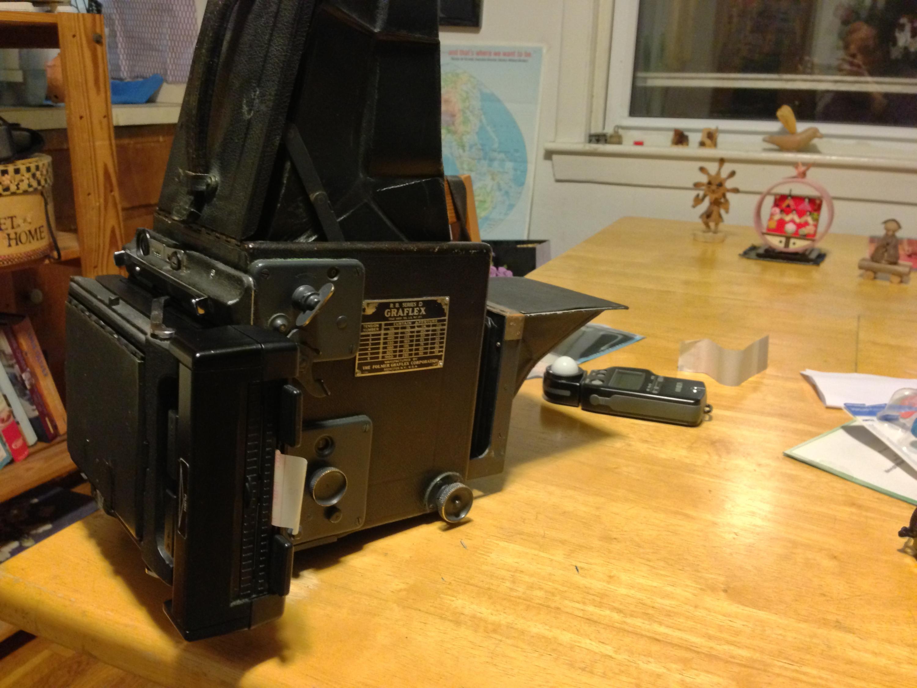

Here you go; got the conversion plate from Bert a couple days ago, finally found the time to do the conversion. Took all of 35 minutes. 100% reversible.
Only issue at the moment is that there's a focus calibration issue, and I may have to adjust the top ground glass to coincide with the rear focal plane.
It covers a pretty big chunk of a 4x5 Fuji Instant film. Need to check with 3x4 Instant as well as 4x5 film, coming soon :smile:

1. Bert's got 20 years on me.
2. A standard film holder backing plate is .197 ± .007 from the film holder edge for formats 2x3 through 4x5.
http://home.earthlink.net/~eahoo/page8/filmhold.html
3. A Graflex film holder backing plate is .224 from the film holder edge in 4x5, tolerance unknown.
4. The view hood ground glass can be shimmed up to 1/8 inch (.125) higher without causing problems, lowering more than .010 inch may require milling the mount opening down.
5. TriX TXP sheet film is .007 inch thick.

The standard film holder places the film closer to the lens making the image out of focus when used on a camera whose ground glass is set for the Graflex film plane. This is the reason the Graflex SLR view hood ground glass has to be repositioned when converting the camera from using Graflex film holders to using standard film holders even if the back is replaced and mounted in the same position as the original.
