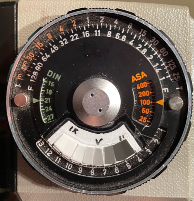

Yes, that makes sense to me now because I exposed a step tablet contacted to my film in the holder. I placed EV12 and 2/3 on Zone X (Schafer's film test method). The exposure was 1/4 sec at f/5.6 and 2/3. The overexposure was intentional to comply with that method. I got curious as to how my spot meter's EV number translates to millilux-seconds.

Here’s how what you did ties the meter to millilux seconds:
You placed 7 2/3 on Zone V
With this setting light meter aims to put: 100 speed film with EV 7 2/3 at -1.1 log mcs. This is ten times the speed point.
But the amount of actual light is greater by five stops. 5 x 0.3 log exposure change per stop means adding 1.5 log exposure.
This is positive 0.4 log mcs. Converting the log value to arithmetic value gives…
2.512 arithmetic meter candle seconds or 2512 millilux seconds.
That’s how much light you put on the film. You put the step wedge on top and it blocked light in steps of 0.15 from 0.05 on the right to 3.0 on the left.
The speed point for 100 speed film will fall under your Stouffer scale step having density 2.50, it will be very close to that.

It dawned on me that maybe you thought I used a supposed "18% gray" as my target. I know that a reflected reading from an 18% gray target is supposed to be tantamount to an incident reading in the same light.......however, my target was white on the north side of my house: sunny, cloudless sky, in diffuse, uniform shade, no target glare, no shadows on the target. I view it as a reflected light reading from a non-18% gray value.
I didn’t think that. A white target would certainly throw out my story point that an incident meter would agree with the spotmeter. But still the light meter was estimating the incident light according to what it wants to put on film.

I'm hearing that my Pentax 1 degree spot meter is actually providing me with an incident reading.....another thing I'm going to have to try and wrap my head around. So there is light that is incident upon the target but the light entering the spot meter is reflected from the target. Is this an incorrect statement?

The Pentax spot meter is a reflectance meter, not an incident meter.
