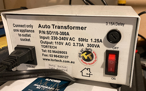

Here in Melbourne I have a 110V darkroom because I bought equipment years ago (cold light heads etc). I use a somewhat expensive transformer from Radio Spares which is centre tapped to earth which can make for extra safety in the unlikely event of an electric shock.
I used to have a Beseler 240V to 110V transformer which came with a second hand purchase. I lent it to a friend who had just arrived in Oz with USA Christmas tree lights. The transformer did not have a sufficient capacity and blew in a minute.

Conversion of the Time-O-Lite timers would require replacing the motor (if you want the time to be correct). If you open one up, you can see that it would be difficult to do because the timer is jam-packed.
Voltage conversion requires two things: the correct voltage; note that Australia is 240 Volts, while most of Europe is 220 Volts; they are not the same. Power conversion transformers can adapt for the voltage. The other thing is the correct frequency: 60 Hz for USA, Canada; 50 Hz for Australia. There is no easy way to convert frequency--it can be done, but the cost is prohibitive.
For electronic equipment, look for a rating that includes 240V (not 220V) and 50 Hz.
Incandescent bulbs don't care about frequency, just voltage. If you use a step-down transformer (240 to 120V) you can use the bulbs you bought. Since the only electrical device in these enlargers is the bulb, a step down transformer makes sense.
