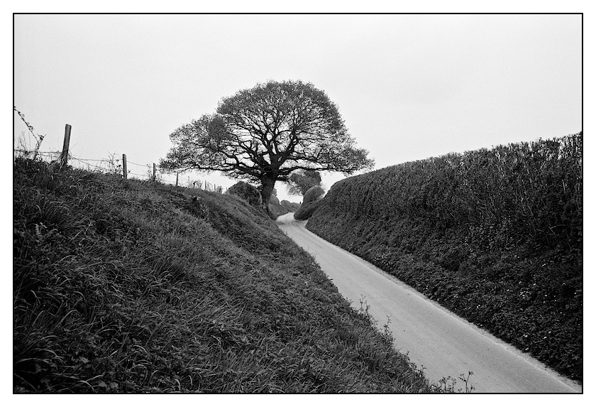

To all those who have given their advice here, my sincere thanks. I will go no further until I have explored all you say.
To DS Allen: I usually give 4 1/2 min in both baths of the BT2b, for both FP4+ and HP5+. I do vary these slightly according to subject type. Funnily enough, the kind of subjects that give me most trouble don't feature at all on your website. They often involve grass or vegetation. Here's an example, which I have 'fixed' digitally here.

It's hard to say what the problem is without seeing negative or print - but the issue would seem to be a bit puzzling since the mid-tones are typically the steepest (most contrasty) part of a film's characteristic curve! Since you say that it is sometimes an over-all problem making specific dodging/burning difficult - like a speckled deep forest with a multitude of scattered deep shadows and sparkling sunspots with patches of "low-contrast" midtones, one approach might be using a combination of increased contrast to perk up the mid-tones, with Selective Masking to dodge the shadows and start with a bit of pre-exposure to tame the highlights. You could also use masking to burn in troublesome highlights with a lower contrast.
