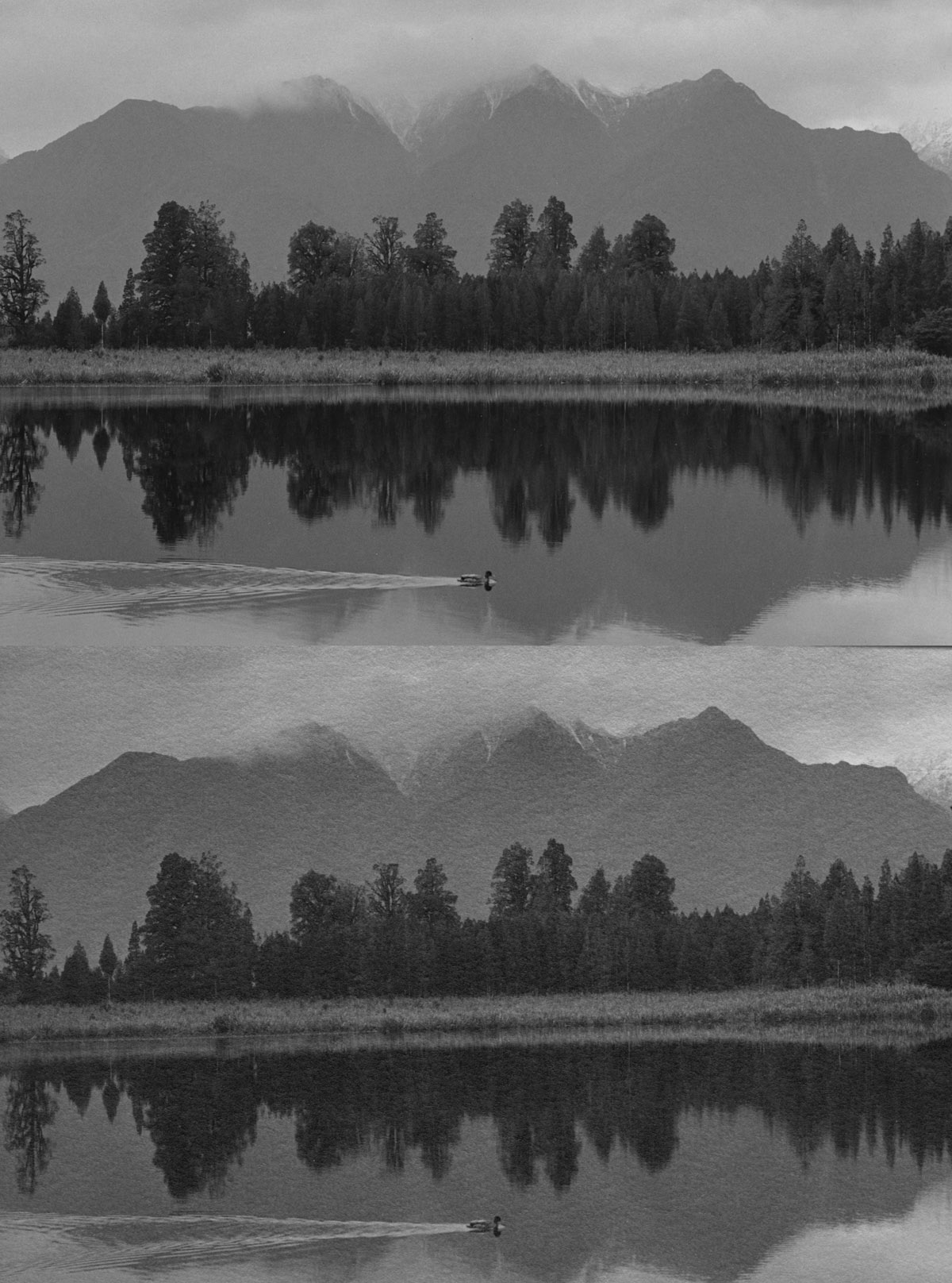

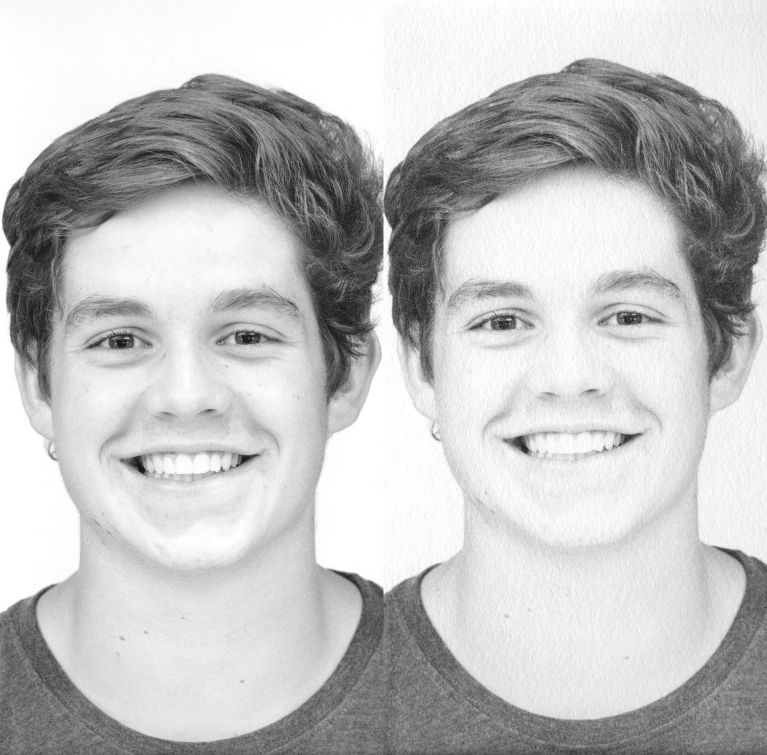

Hopefully this works. I made 2 comparison prints. I've scanned the prints together so even if they don't look exactly the same on your screen as on my screen and the actual prints (they are pretty good match between my screen and the print considering reflective vs backlit screen), they will be relative to each other without the scanner adding to the confusion! Since the scanner can't scan all of both prints at once I've tried to clip out a similar section.
First one is my son, left is Ilford RC, right the Art300. Important print parameters were :
I/RC - 12.5secs @ f11, 60M
Art300 - 25secs @ f11, 60M
Second is Lake Matheson, NZ, top is RC, bottom Art300
I/RC 14sec @ f11, 40M plus burn (time not recorded) on sky
Art300 13sec @ f8, 40M + 10sec burn on sky

Yes there is clearly a difference on my screen, especially in the portrait shots where there is a lot more highlight tones. The RC looks to be the better print but no doubt the Art 300 can be made to look as good. I have never tried the Art 300 but it makes me wonder what are its advantages over Ilford RC given what your scans show. As a paper it seems to be a stop slower which may be an advantage I suppose depending on what time the printer needs to do his stuff under the enlarger.

The Art 300 print of your son needs to be printed longer to match the highlights.

It's not just that there's more contrast, the highlights are almost completely blown out. As mentioned, this is strange behavior. Do some test strips and play w/ the exposure times, experiment w/ filters, etc. In any case, do that on the test strips, not the prints. One or two strips, w/ and w/o filters, should fix it. I'm also wondering if the paper has had enough time in the developer to get those mid tones to appear.
looking at this on screen (at work,) I'd agree, didn't get that feeling on screen at home... will have another look at home. Will need to look at the prints again (they're at home too).
Also did you click through (ie. click thumbnail. right click, view image, click to view full size) to the full size images?
regardless, I don't think there's a huge difference in contrast. Maybe the surface differences (RC was Pearl) have effected the scanning and I'm sure looking at this now, screen brightness is an issue (none of my screens are calibrated).
After close examination of the prints, I'm going to agree with this, but not to the degree the scans imply.
I'm wondering if this behavior is at least partially related to the surface of the Art 300 paper, and how it presents an image.
I reckon this contributes. In my examples the RC is Pearl so if I was serious, I'd reprint using matt paper, probably FB.
However, in my two examples, I can't see a major difference (ie. 1 or more) paper grades. That's IMO and YMMV :smile:
Yes! To compare contrasts first match the highlights not the mid-tones or the shadows. Then if the shadows are too dark take out some contrast. Go from G3 to G2 or even G1 if you have to. And go the other way if the shadows are too light. It's a nice question when changing contrasts what becomes different and what stays the same. Answer: the highlights are set by exposure and stay the same and the shadows are racked up and down, lighter or darker, by changing contrast.
