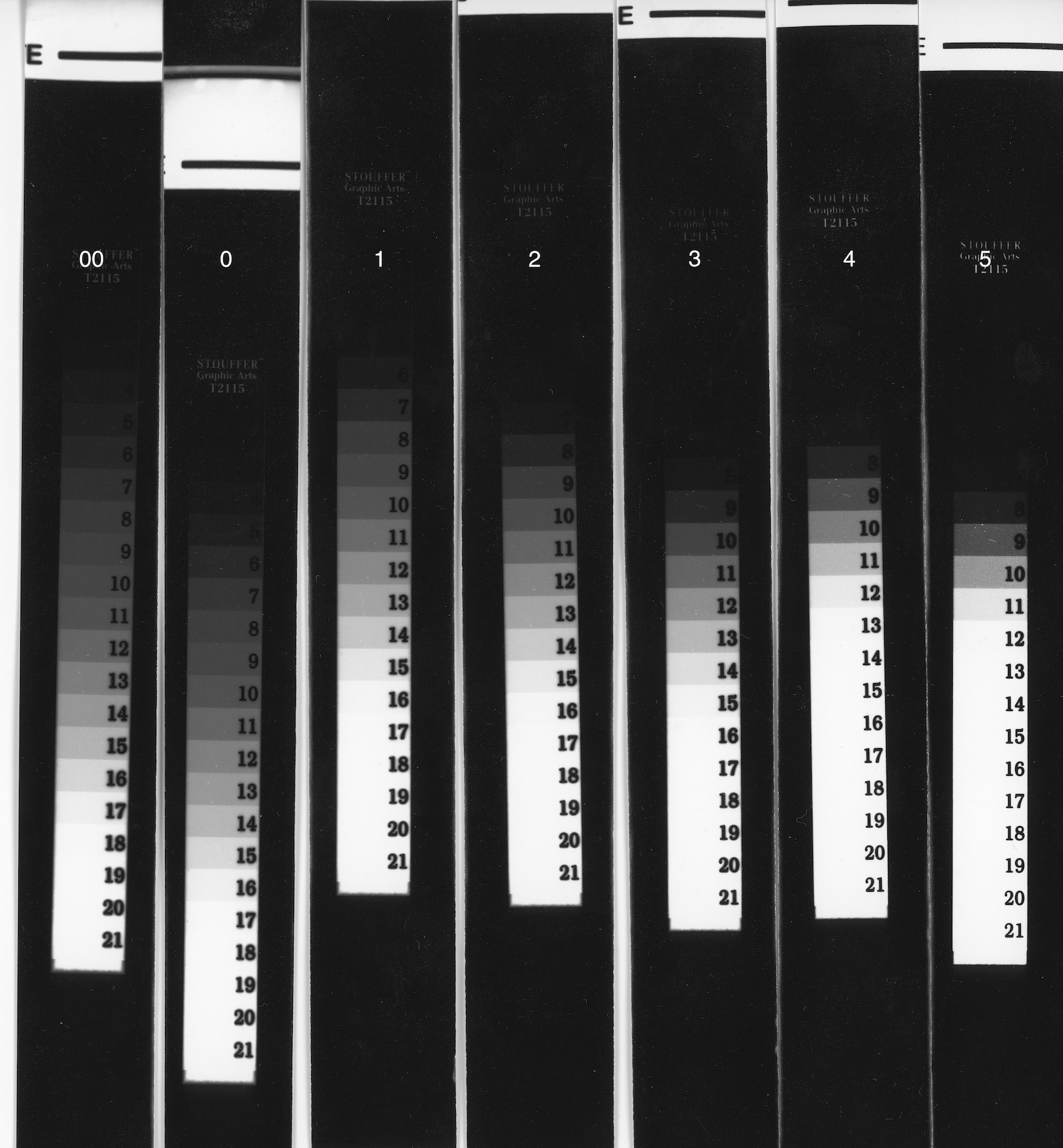

Here are some test strips I made for calibration purposes (Stouffer transmission step wedge) on Ilford Multigrade IV RC. The actual numbers are not important for this discussion but the strips illustrate how contrast increases with increasing grade number. It also illustrates how there are more grey tones using a softer (lower number) filter and fewer with a higher number filter.
Picture attached.

That's a good illustration, but one statement was potentially misleading. A harder grade paper doesn't necessarily diminish the amount of grey tones,
but can in fact bring out even more via accentuating microtonality. It all depends on the contrast in the original negative, along with how one might dodge, burn, or mask that particular image when printing. Even a Grade 1 paper can be turned into proverbial "soot and chalk" if the negative is too
contrasty in the first place. I've taken negs with no visible image on them at all - just the pyro stain itself which can only be seen through a deep blue
filter - then printed onto the hardest grade a VC paper will achieve, using a deep blue 47B filter over the enlarger lens, and ended up with incredibly
nuanced grays and internal detail. Old school wisdom called for "thick"(overexposed, overdeveloped) negatives and soft papers. I often do just the opposite, though it is critical to maintain threshold shadow separation in the original shot. The proof is in the pudding.

I'd like to try printing just the stain and see what actually happens. Presumably a film like FP4 should stain pretty well in a strong-stain developer like PMK or WD2H. It would be a difficult comparison to make though.
I agree it is potentially misleading to say lower grades print more greys. In fact every grade prints the same continuous scale of greys from d-min to d-max. The difference is the log H range.
