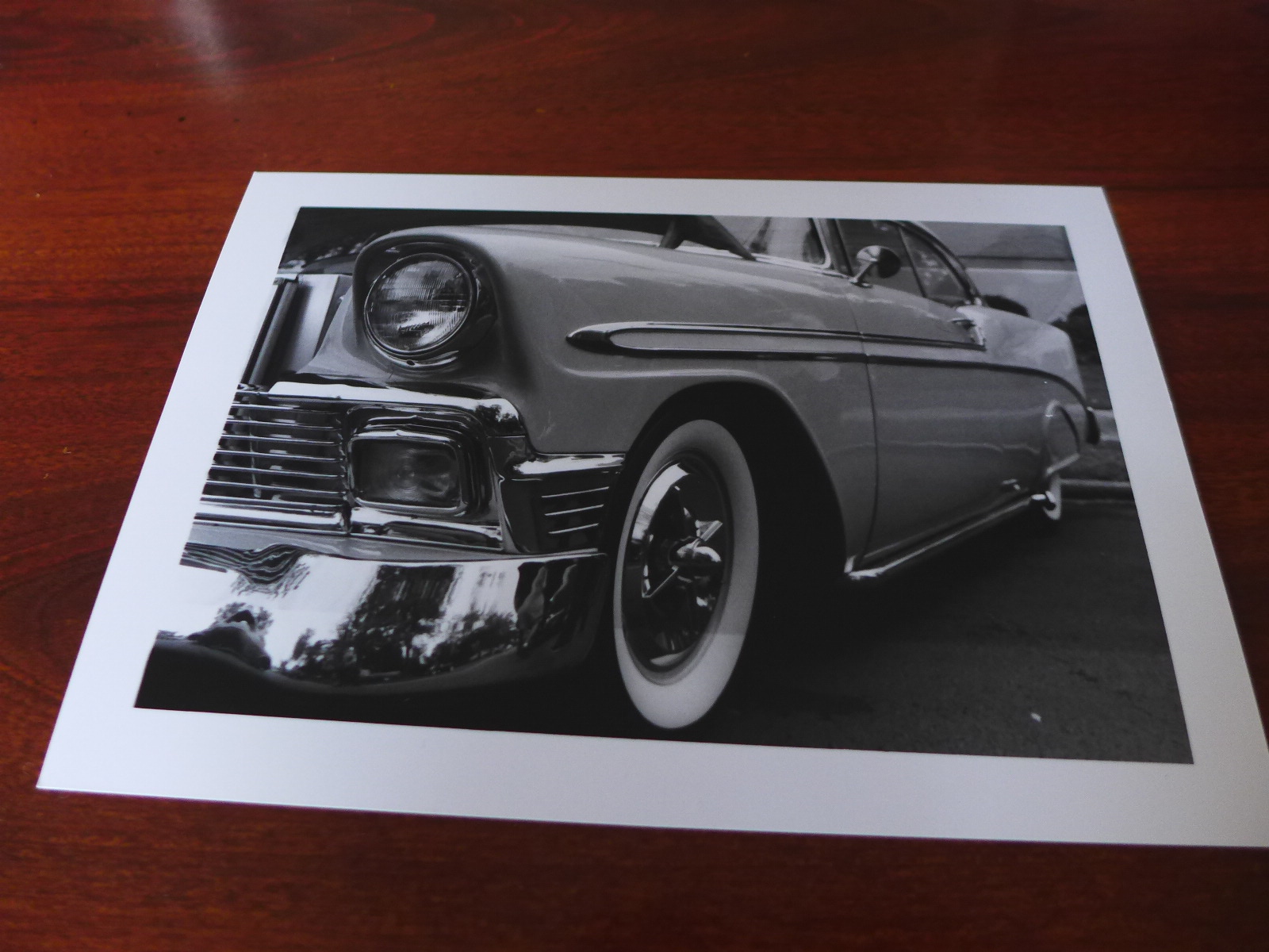

I've been practicing with the negative of a classic car that I mentioned on the other thread. I read the link you provided, then also tried your suggestion of starting with the shadows (5 filter) first, because I had a black tire with some texture and a completely Zone 0 wheel well.
I used test strips on that part of the photo to arrive at an exposure time of six seconds (I could stretch that out, but I am having no trouble with the time so far). I then exposed a full strip for six seconds on Grade 5, then added 2 second intervals with Grade 00. The Grade 00 filter darkened the paint on the car so much that I couldn't really choose a time based on how it affected the highlights - it would darken the paint too much. I had to stop at two seconds. I guess I could stretch the overall exposure out with a smaller aperture, but I don't know if that will give me what I'm looking for.
I can work with all this if I know what to expect in the mid-tones, but it also feels like I am not going to have as much control as I thought.

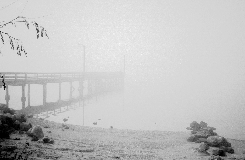

I generally only start with the grade 5 filter if I am working with a predominantly bright and light subject, with only small areas of dark image. Something that might be referred to as high key.
Shots taken in bright fog are a good example.

I am not trying to print something amazing (it's not even a remotely good photo) - I chose this image specifically for PRACTICE only. And I chose to do the 5 filter first because I wanted to practice separating some dark tones. I will practice on another negative to practice separating light tones.
Am I wrong to start with the the 5 filter if those are the tones I think need to be addressed most? The rest of the image is easy enough. It is actually a pretty well defined negative other than the tones I am purposely working on.
It will be hard to tell on this photo, but the negative shows that there are different tones for the tire and the wheel well. I was practicing trying to get some separation there:
As someone has said before, in this situation you need to expose your test strips with the chosen 00 exposure first, then work out the 5 exposure. Otherwise the small impact the 00 exposure has also in the dark tones will further darken the shadows beyond what you wanted. In what order you expose the final print makes no difference.

Here is an example of an image where I would start with the #5 filter:
For your test image, I would start with the 00 filter if I was using split grade.
When you have achieved the print you want with split grade techniques, try printing two more prints from the same negative, without changing any settings - one print with just the 00 filter - same exposure time as in the finished print - and then another print with just the 5 filter - same exposure time as in the finished print.
I predict you will be amazed at how much of the final image comes from the 00 exposure, and how little comes from the 5 exposure.
Remember, contrast is created by adding density on top of density, not by one filter doing one thing, and the other filter doing another.
(PS that example is a bit of a fudge, because it is actually from a colour negative. I didn't have a good black and white example digitized and close at hand).

No dodging or burning on this one yet. It was my understanding that the 5 filter affects the darker tones more, so I was trying to dial it in to achieve some separation of two dark adjacent tones: The tire and the wheel well. This is specifically what I was trying to learn and practice with this negative.
I am trying to learn how the filters affect each of the tones and how best to get well defined tones BEFORE I dodge and/or burn. Seeing that the filters affect the mid tones so dramatically gives me concern about dodging and burning with them when I start practicing that.

I printed for years before I started doing selective split-grade printing. I have negatives that would not be possible to print to my liking without it.
The technique you're using will not necessarily help in many situations and is not a magic fix. Using split-grade of the overall image will impact the mid-tones, as some here have already stated.
I'd try getting a satisfactory straight print between grade 2 and 3 first, with the midtones exactly where you want them. If the darks in the area of the tire and wheelwell are still blocked-up and you need more separation, try dodging that area during the main exposure. If that area starts to look too muddy, back off a bit. If you still can't get any tonal separation, that area on the negative may be too underexposed to show any detail.
Also, if you lose any highlight detail in the reflections on the bumper and wheel, you can try selectively burning-in those areas with a grade 0 filter.
There's tons of different techniques to get where you want, so don't get frustrated after only 3 sessions. I've taken weeks or months to get some negatives to print the way I want.
