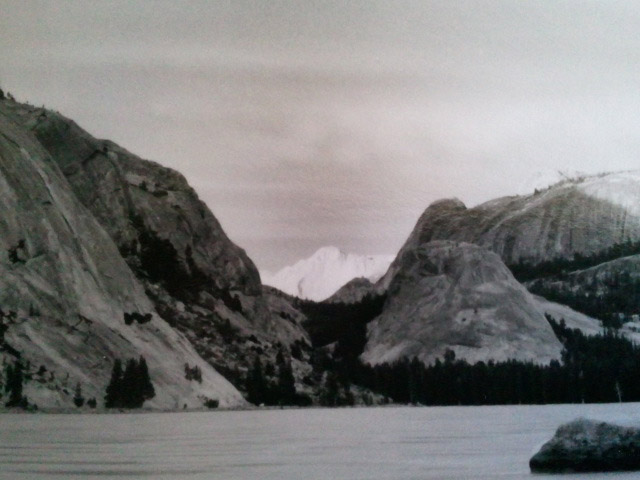

I asked this over on lfphoto.info.... but thought I would try it here also
I have a 4x5 negative that has one little area I would love to be able to print with detail. The negative is pretty easy to print with the exception of the super bright Mt. Connesss in the background. I tried burning but had trouble not over burning the surrounding areas.
Attached is a scan of the neg with some contrast control done in photoshop... (sorry for the digital image, I'm weaning myself off Photoshop and back into the darkroom)
Flash the paper? Mask? Split Grade printing?
Any other ideas?
I marked this negative N+1, but I guess I didn't see that Mt. Conness had slipped into full sun when I pushed the plunger.
I will process the other neg at N or N-1 that I shot at the same time, but was just curious about this situation.
Thanks in advance
Robert

I would try a preflash first with non-image light. Basically you want to fog the paper in that area right up to the point where you see the slightest gray, then print your neg. The trick is going to be alignment if you don't use a pin register. What I would do is make a cardboard mask with the mountain cutout. Then use a small penlight to flash the area while slightly moving the cardboard. Even the addition of a little gray should make an improvement.

First the mountains in the distance while bright are not blown since there seems to be a lot of good detail in them(top pic #1)
If you are trying to get the eye to NOT go there I would think that a dodge would be the choice to hold back some of enlarger exposure,resulting in less whiteness to the specific peak, not adding light to then burn it out.
What exact detail of the pic are you thinking of printing?

Just a note on flashing. I have an electronic timer that can be set in tenths of a second. (If flashing is the route you want to go) what I have done is to make a guide at the usual magnification levels I generally print at and the paper + a contrast (Aristo VCL or use a filter) in tenths of a second fully processed and dry. I can see what the flashing (no negative in the carrier) will be. I can then know how long I want to flash for. Of course sometimes you have to make an adjustment for the final print but you could preflash at different times on a test print sheet. Couple this with some of the suggestion above.

Well, since you sound like you are familiar with hybrid processes, you could print out a little transparency (digineg) of that spot, cover up the rest of the print and burn in that way. But people on here are going to shoot me now, so if you do, don't tell us.

You could perhaps print the area of concern a stop or two darker than the rest (with standard dodge and burn techniques) and then bleach that area selectively. Selective bleaching can really boost contrast a lot. Depending on your bleach, you can reduce proportionally or attack highlights and lend 'brilliance' to them.
Nutty though it may sound if you haven't tried, you can also print small parts of a print at a different grade than the rest, I have played with this and all you do is use multigrade paper and filters and experiment. Under the enlarger, you can lay the filter directly on the print until you figure out which filter and exposure ratio to use, and go from there.

I would second the notion to burn the area with a double 0 or 0 filter.
I think you will find you can do this without changing the darker surrounding areas much. Especially if you keep your burn spot on the white mountain and below.
Don`t worry about exposing part of the darker mountains. If you use a cutout circle for the burn, the top quarter of the (pie) shape covers the white and the bottom three quarters can safely be over the dark mountains.
If you have never done this split printing you will be amazed.
In addition, a brief number 5 burn of the white mountain will selectivly darken the crevices, but you will have to stay within the area, as then, the surrounding area will be darkened

Although on review of the image, you might find you like that bit of white.
What if, instead, you bleached the flat light grey rocks or ice in front of the big rock to balance the mountain.

First, I would try to flash the paper. I really like the very bright mountain back there, and you only want to get a hint of texture.
Selective masking would be my second method to try. If you wish to just burn in the area you could make a mask and cut out the area that needs more exposure. You get about 1/3 to 1/2 stop reduction of speed with frosted mylar, so what you would really be doing is dodging the rest of the print by that amount. You could also also do some additional dodging, burning or local contrast adjustment with the mask on the rest of image. For example if you want to increase the contrast of the large mountain on the left you could add a bit of magenta to that area of the mask with a highlighter or colored pencil. That would lighten it a bit and increase the contrast locally by blocking some of the green light. You can also fake it with a bit of pencil shading.
There is really no way your development could have really helped you. If you had given the negative less development time, then you would have had to increase the contrast for the printing to get the rest of the print the way you like it and you would be right back to where you are now. So don't beat yourself up over that.

Flash the paper will bring this in. Non Destructive also.
Combine with or use split filter printing alone. Start with low contrast, then when the peak is correct, add density with high contrast filter.
You might try masking, single mask to hold everything back except the white.
Also try a small cut out slightly smaller than the size of the peak and lay it right on the print. Move slightly during exposure.
Definately go with a diffusion enlarger if you are not using one.

I personally dislike flashing because there's more risk of compromising the gradation of the low values. Split printing on a high-quality VC would make this a fairly easy task provided the high values
of Mt Conness aren't blown clear onto the shoulder of the film and still retain some gradation. I'd simply make a relatively precise cutout on a burn-in card and give that specific area some green or
yellow light exp. (Actually, I'd personally use a registration punch and special mask to do the burn
exactly, but most people don't own that kind of gear). Good timing with that shot, however!

Wouldn't it be possible to use retouching ink? The area looks quite small to me.

Thanks for the help all... I did a lot of paper flashing back in my days as a newspaper photographer making screen prints. was never really a fan of that technique, but were doing it in a pretty low tech way.
Been chatting with Alan Ross and he's given me some great suggestions... He thinks selective masking is the way to go on it.

a contrst-controlling msk will do the rick
