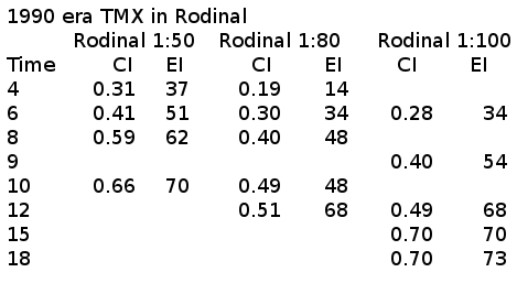

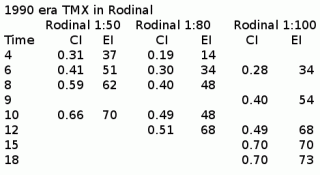

FWIW, here's a chart derived from a more comprehensive set of data published in Kodak Tech Bits, Issue 2, 1990, page 8. This data is for 1990 vintage TMX in Rodinal at three dilutions. Tests run by Nancianne Judge and Jack Holm of RIT under guidance from Kodak's Scientific Imaging division. A single run was done for each film/developer/dilution combination.
TMX is probably more sensitive to variations in time than older style emulsions. TMX has changed since this data was published.
An interesting article, with Tech Pan and TMX tested with 12 different developers/dilutions over times from 4 to 21 minutes. EI and CI derived for each combination.
I miss Tech Bits. You could subscribe for free.
Lee
