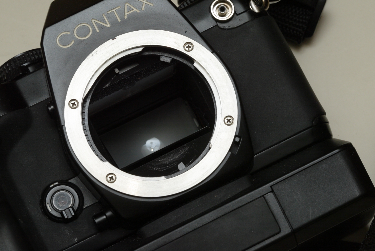

A small dab of contact cement on one surface works pretty well and is reversible unlike the super glue/caulking options.
Thanks, John. I actually had three or four products lying around here that I was considering, including DAP Contact Cement. I elected not to use that one because it said it was for "wood, rubber, paper, leather, and fabric." The stuff I used specifically mentioned metal and glass. You're right, though, the repair I did, if it holds fast, will not be trivial to reverse. That was one of my worries, but again....the impatience thing....:D

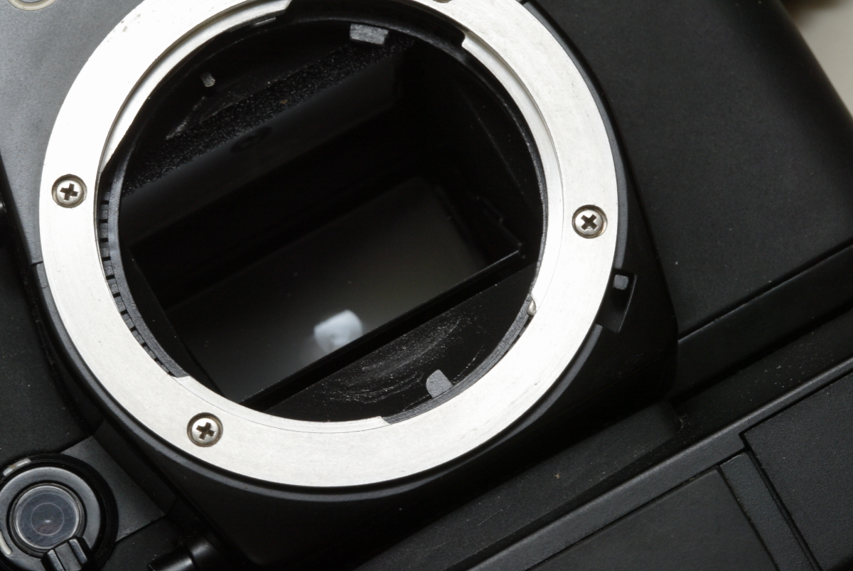

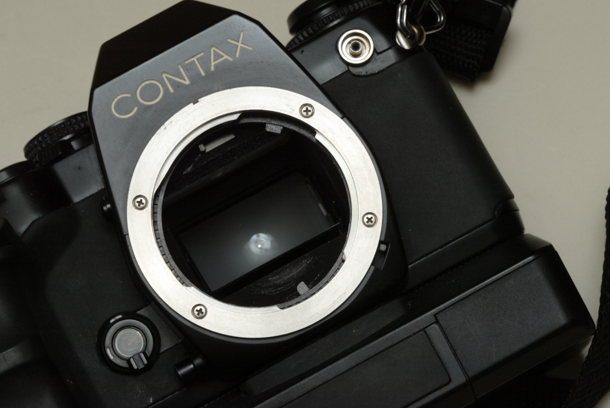

I tried the pushing it back into place thing, but I could watch it rebound a little bit, so I kept going until the adhesive was soft enough to remove the mirror. Then I cleaned the mirror and reglued it with some window caulk. LOL, I am impatient, and that's all I could find. I'm going to make a blog post about the repair later today (I hope), and when I do, I'll come back and link it for anyone interested. :smile:

Did you see my post about the repair? I'm not sure how different the mirror and carrier arrangement would be in the 159, but if you hold the shutter button down so the mirror is up, you can see if the edge of the mirror is flush with the carrier frame. I would suspect that it should be. Hopefully it doesn't look like this:
http://no-exif.com/wp-content/uploads/2012/04/slipped.jpg
Bruce, also see the last two pics in that blog post:
http://no-exif.com/2012/04/18/new-contax-rx-repair/
They are from a different angle, showing the spacing of the mirror's bottom edge relative to the mirror box floor. From your pics, your mirror seems to intermediare in distance between my before and after pics, but the 159 is obviously a totally different machine, so yours could be exactly where it's supposed to be.
