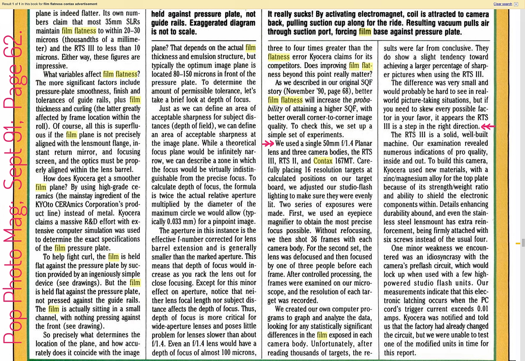

But, draw your conclusion after reading the test on Pop Photo Sept 91 Page 62.
If you are busy, you can read only the 3 paragraphs between the red arrows.

Actually the Contax RTS does not have a ceramic pressure plate. The RTS II does neither. The ST and RTS III do have one. Not sure about the AX.
RTS III, also created a vacuum which along withe ceramic film pressure plate kept the film as flat as possible. Not sure if the RTS II had the same back as the III.
Yes, the idea was not the material of the plate, but the vacuum.
