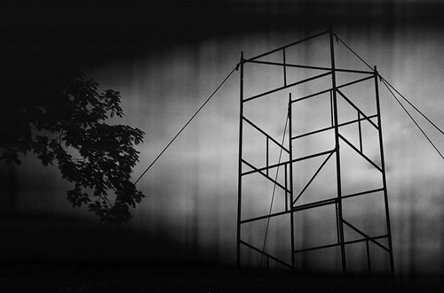

Hello forum,
I have a 95% functional early model Contax IIA (serial#: P 97460). The shutter works properly at all speeds with the exception of 1/1250, where it produces an uneven underexposed region at the top of the frame and in some photos, at the bottom as well, also, streaking effects.
Here is a typical example:

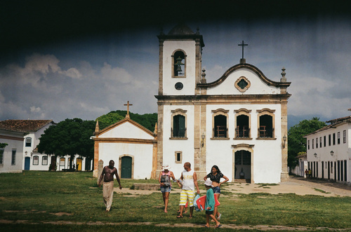

Here is another example of a shot that I took at what I thought was 1/125 (a speed which the IIA doesn't have!) but was actually 1/1250. I played around with the contrast on this image and unfortunately can't presently find the raw scan. Regardless, this image shows under-exposed regions at the top and bottom of the frame and heavy streaking:
The technician that restored the camera has offered to take it back in to see what can be done. I wonder if anyone here can please suggest what might be happening from these photos, so that I might be able pass this information to the technician?

Does the IIa have a vertical or horizontal shutter? I had a similar problem with my Spotmatic. The Spotmatic has a horizontal shutter, and at the fastest speed, the distance between the leading and trailing shutter was small. The leading shutter was dragging a bit, so the trailing shutter would close the gap as the shutters moved across the film plane. At the top speed, the trailing shutter would catch up with the leading shutter about 75% of the way across, so the remaining 25% wouldn’t get any exposure. That would leave the left side of the frame (the right side of the image) would be black.
On a vertical shutter you could get a similar effect, but it would be the top portion of the image.
The Contax has a vertical shutter. I thought dirt rather than the blades dragging b because the dark region is curved while the shutter blades are metal and straight.
could be. at minimum the camera needs the shutter looked at to see if its the blades or an obstruction.
The IIa, like the IIIa, has vertically travelling metal slats that are driven by a gears rather than the cloth straps of the II and III. It appears to me that if dirt or some debris is not the problem, then possibly one side of the shutter blades (slats) is travelling faster than the other and also that their motion is not uniform.
Only someone familiar with this Contax shutter should be working on it - perhaps the best you can do is look at the shutter when it is set to B and see if you can spot any debris around the film gate.
Thanks for the replies everyone. Yes a vertical shutter. I can't imagine that there is anything obstructing the curtains, it's had a very thorough service and the technician is a good one. I will check though of course with the bulb setting, thanks. It has film in it at the moment so I'll have to get through the roll. One thing that I didn't mention is that the technician had said that the curtain has been repaired at some point in the past (a curtain may have torn in the past, that was my understanding), perhaps that explains the unevenness....
The 'curtain' is metal slats and cannot tear.

Well, I find the pics interesting, especially the B&W one that is quite a piece. Don't fix the shutter, just use the camera as a digital and leave results to chance :smile:
As Theo says one side of the curtain is moving more slowly. Sometimes caused by a slight difference in
the length of the curtain tapes or a slight difference in diameter of shutter rollers. Maybe a film chip or fuzz?^^^^
FWIW I'd be surprised if the speed can be adjusted anywhere close to 1/1250
simply from wear & tear(old age).
Well, since the shutter consists of metal slats driven by gears, it is possible that alignment is off somehow on one side or something is retarding the movement on one side.
I suspect a repair person is going to have to look at it - be sure to show the negatives when you take or send the camera in for service. ...and mention you see this only at 1/1250.

Unlike a between lens shutter the speed does not completely rely upon a spring tension to operate which will of course weaken off over time. Focal plane shutters from the lowest speed to the highest, all work upon two shutter curtains travelling independently over the film and exposing it. The actual speed is governed by the 1st curtain passing the over the film followed by the second but as the speeds rise the gap between them decreases. For instance at 1/30th the 1st curtain may probably uncover the whole film frame before the 2nd curtain moves. at 1/1000th the gap between the 1st and second curtain may be only as little as 3mm. For this reason Focal plane shutters at high are generally more accurate than leaf shutters. 1/500 is generally the highest that can be set with a leaf shutter. A properly adjusted focal plane shutter will generally retain it's accuracy over a very long period.
A phenomen of the focal plane shutter travelling across the frame at slower speeds will show the wheel of a vehicle travelling in the same direction with an visible distortion. In extreme cases this distortion can make a circle appear like an egg in shape.
However the metal slats of a Contax shutter do have an un-enviable reputation of developing faults which were never really were sorted out and this may be one of them. As to what is causing your problem I simply have no idea and it may be only a technician can identify it.

Although the IIa has a different shutter to the II on with the Kiev is based, my Kiev 4 exhibited an identical issue at the highest shutter speed in the rolls preceding complete shutter failure. My guess is the shutter is on its way out. Until you posted your examples, I've never seen the same phenomenon anywhere else.
Blockend, I agree. Time for service. Since availability of parts can be a problem, better to service now than wait until shutter is kaput.
Thanks again everyone. I finished the film that was in the camera on the weekend and took a look at the shutter curtain. Despite being metal, it definitely looks like it has been "torn" at some point along one of the joins between the main slats of the curtain and "soldered" (if I dare say it) back together again. No dirt or fluff from what I can see. I don't doubt that the shutter is on its way out and yes, perhaps i'll have to live with a max speed of 1/500. I like to shoot with wide apertures quite often, so I'll try and keep to slower film. When I bought the camera, I also bought a second broken IIA body for parts. Although the shutter in this is likely to be in a worse state (the shutter is completely jammed), I'll take it in with the camera to the technician today, perhaps he'll be able to salvage something from the second body. All the best!
