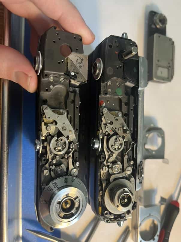

Got the contaxes on the slab and have them opened up for CLA. So far, it looks like the swap is possible.
On the left is is black dial iia with mechanical sync (requiring an adapter to use flash), on the right is a fully synchronized color dial iiia (with the meter removed). It seems like both bodies use the same shutter chassis. The iia top plate fits fine on the iiia at it appears that the threaded holes necessary to attach the meter and iiia top plate are present in the iia.
The main difference afaict is the different rewind shaft which hopefully i can just remove and swap between the bodies.
