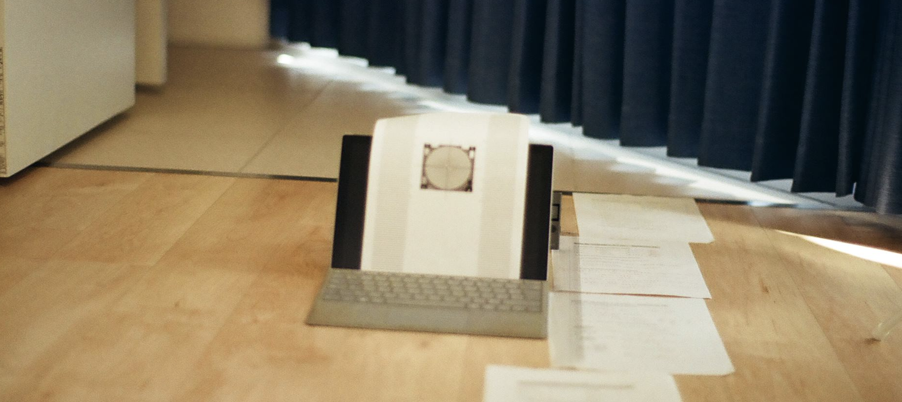

So I shot a test roll with targets and sure enough all the images are backfocused:
* If I focus on an object "20m away" according to the split prism or the autofocus, the object is actually at infinity.
* If I focus on an object "2.5m away", the lens distance scale is at 3m.

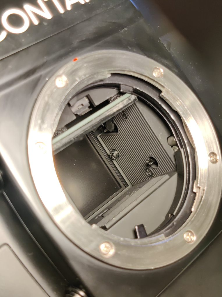

After making sure the camera had never been opened before (factory thread lock is still in place), I concluded this was a botched mirror reattachment job.
So I spent some time with acetone, ethanol and carefully loosened the adhesive used. With a very thin blade I slowly cut the mirror away from the carrier.
Sure enough, indeed someone did some double tape magic here in the past. I very carefully removed the goop from the carrier (taking care to remove the focusing screen first and not ruin the black flocking paint with the solvent), and also cleaned the back of the mirror with ethanol and patience, taking care not to scratch the front.

For instance, in this shot I focused on the target, which was 2.5M away. The target was in focus in the viewfinder. But the lens distance scale showed 3 meter and sure enough the actual focus point is 50cm behind the target.

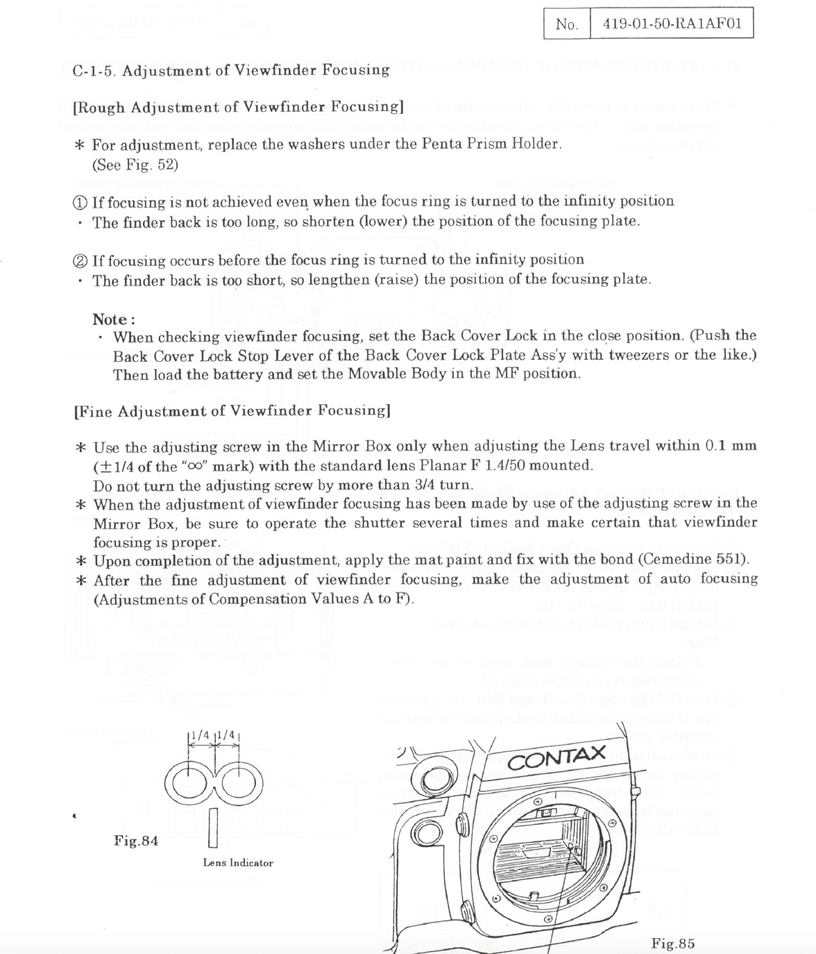

The official repair manual says that focus adjustment must be done by opening the camera, shimming the washers under the viewfinder, and then corresponding adjustment via software for the AF CMOS.
The fine adjustment for mirror position is only for very small adjustments (mostly due to variation in mirror thickness)

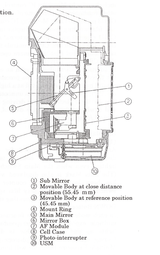

The reason for this is, there is a secondary mirror that reflects down to the AF module (see items 2 and 7 below) so you can't adjust the position of the mirror or the AF slit wouldn't align.
The repair manual says, if the mirror ever unsticks from the carrier, call contax and get a new mirror assembly, but that's not really an option here.

Manual says, you can adjust at most half the length of the infinity symbol on the lens.
As per initial discussion however, the distance is off by roughly half a meter on the 3m scale.
If you calculate using the formula and looking at the distance scale on the planar, the screw should be able to adjust for roughly .01 mm in thickness variation.

Having received and installed the new tape, the focus is now less than a quarter of the infinity sign turn off.

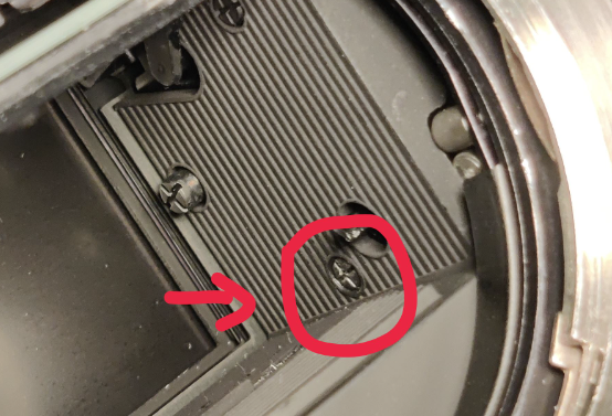

So I wanted to proceed to adjust the mirror stop, but I realized I do not know how to turn this screw, since I can't properly reach it with my JIS screwdrivers.
The screw is pretty tight, and it is dangerously close to both the shutter and the mirror. There is no way to hold the shutter open aside from bulb mode, so accessing from the back is not an option or I risk damaging the shutter; anyhow the screw is equally recessed from the back side as it is from the front side, so I still have the problem of how to turn it with my (straight) screwdriver.
How to turn this screw at an angle? What tool should I look for?

Is there supposed to be a rubber O ring on this screw?
I may have it confused with some other kind of camera.
If you can get a long-ish philips driver that's the right size, you can heat it up with a propane torch and bend it to a right angle. Heat it again and plunge it it water, or the tip will lose its hardness (which it may do, anyway).
I don't think it's literally a philips head screw - the slots go all the way to the edge.
I would take a long, narrow flat head screwdriver and try to reach it at an angle. Because it is an adjusting screw and not a fastening screw, hopefully it won't take much torque to turn. There are L-shaped (offset) screwdrivers for awkward reaches like this, but they're usually much larger. Another option is, if you can find a screwdriver bit small enough to fit that screw, hold the bit in a wrench to turn it.
But really, a long small screwdriver as reddesert says is your quickest way forward.
An update (and I think if there's no suggestions this might be the last update, since I'm completely lost on how to finish this repair).
Using both a long thin screwdriver as well as an offset (L-shaped) screwdriver I reached the screw.
The thin screwdriver was a JIS + screwdriver and for the L-shaped I jerry-rigged a JIS + point and an L-shaped wrench.
Neither of these was able to turn the screw, not even one bit. Some of the screw paint chipped off but the screw itself won't budge. I applied acetone with a q-tip and waited and tried again, but nope, the screw will not budge.
The manual says to apply a mysterious 'cemedine 551' after adjustment, and I assumed this was some sort of epoxy, but I cannot see it anywhere on the screw and acetone 99.99% didn't seem to help.
I also assumed that the adjustment screw would need minimal torque to move, but that's not the case. I am about to strip the screw's head, and it still won't turn.
What am I missing here?
