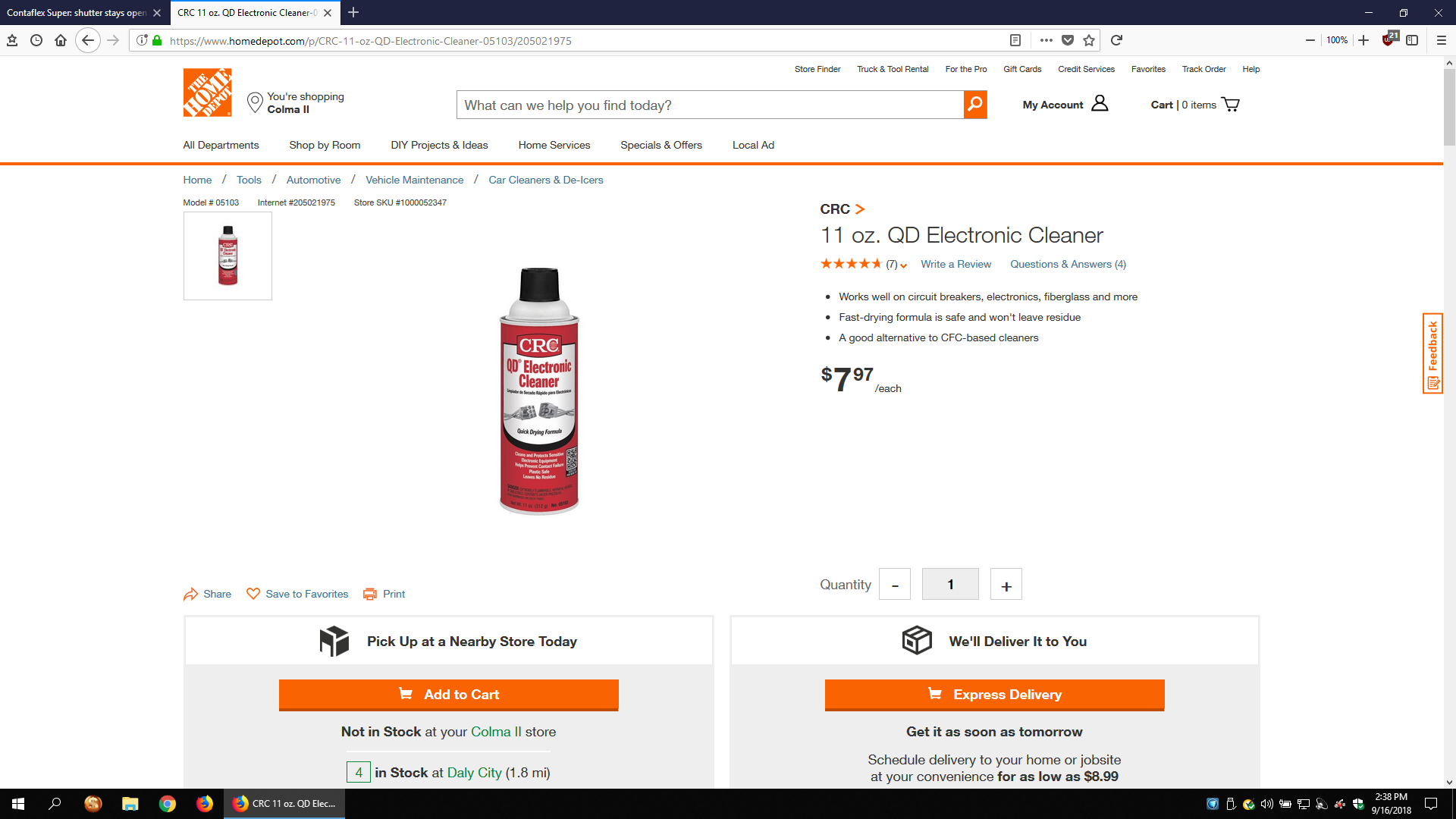

Go to your local Home Depot and get a can of CRC Quick Dry Contact Cleaner
Remove the lens cells and flush the shutter out and operate it while wet with the cleaner, it might get you some extra operating time before the tear down is an absolute necessity.
