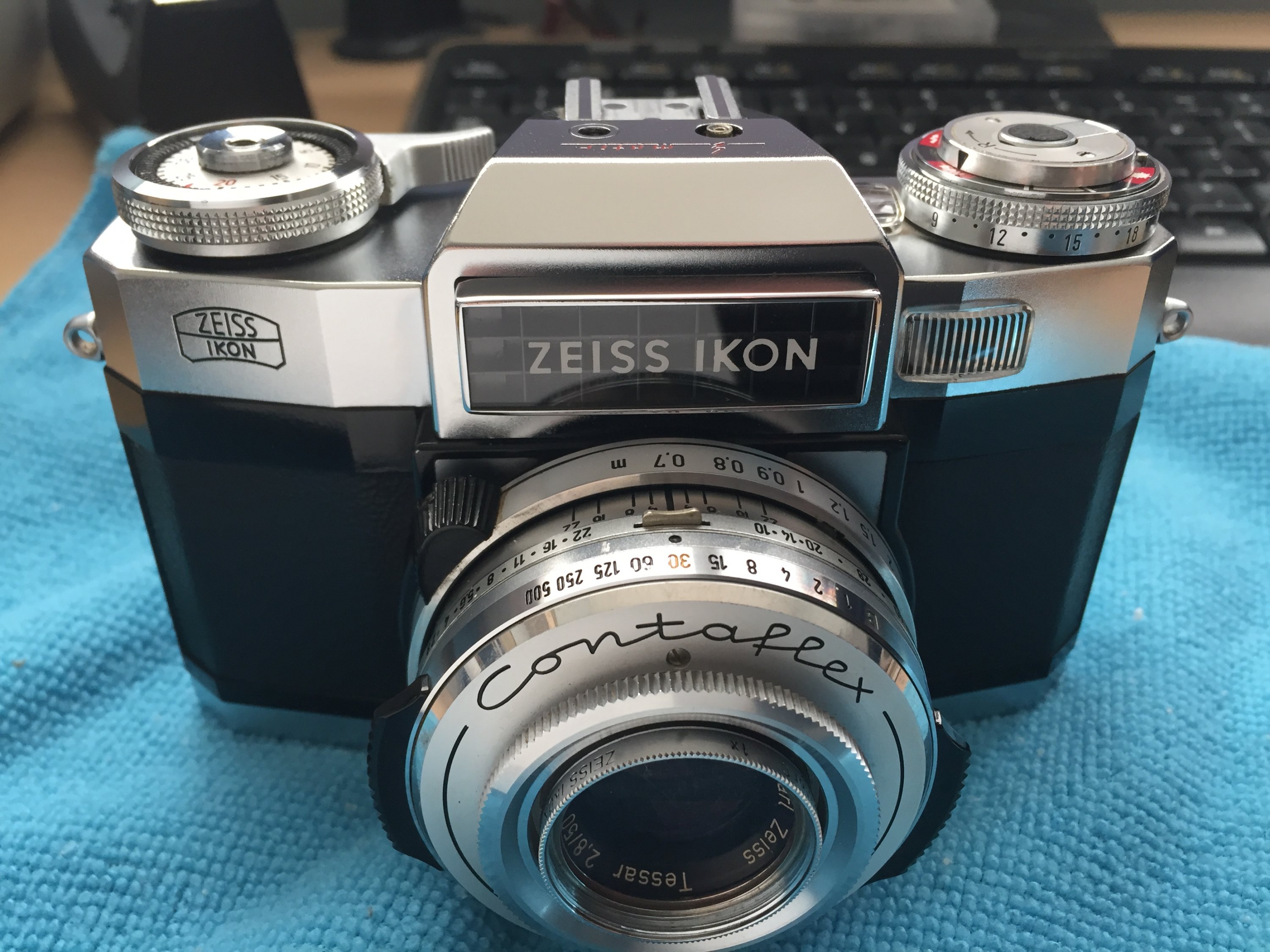

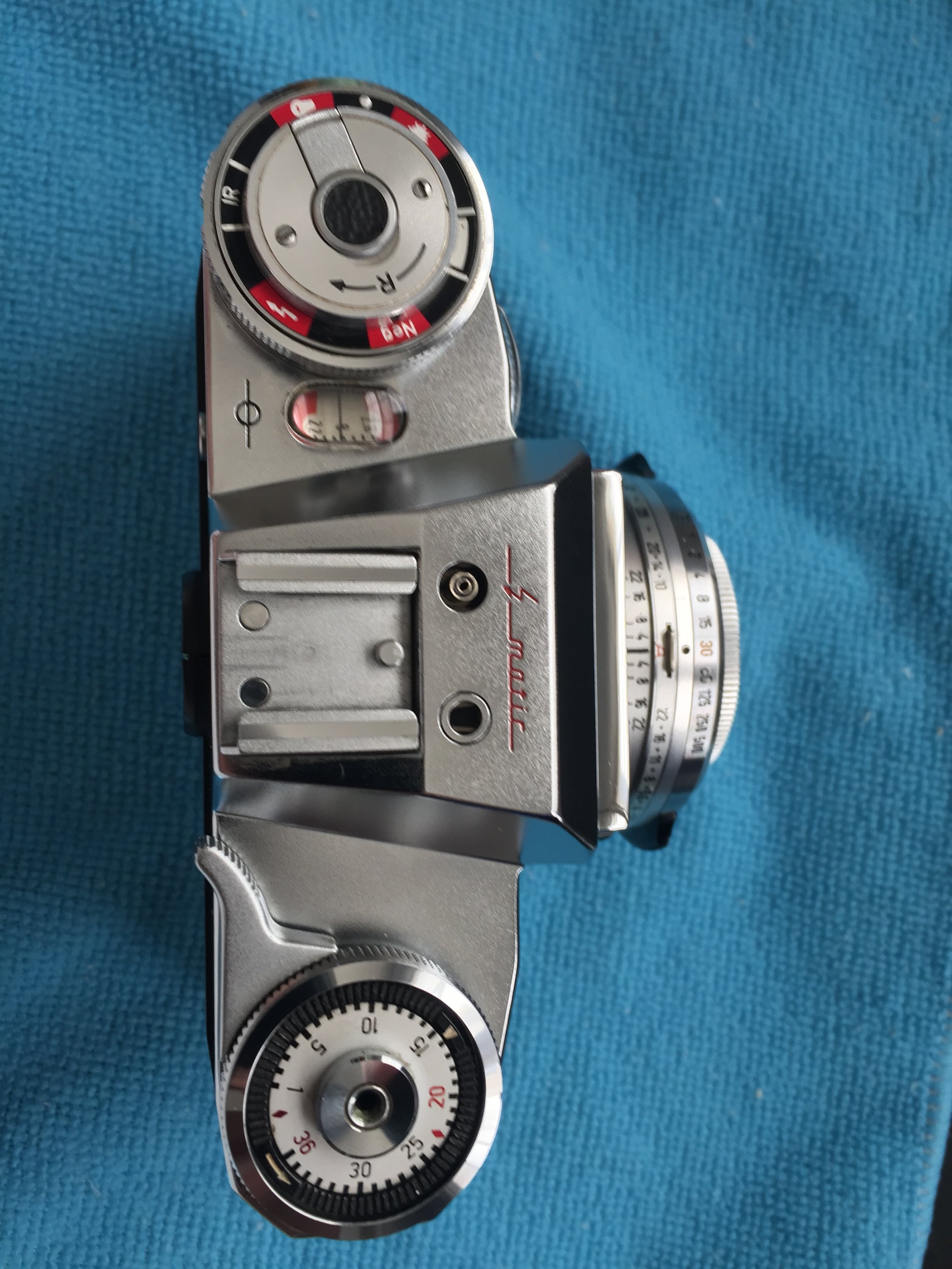

I have come into possession of a very clean Contaflex Super B camera with the 35, 85 and 115 Pro Tessar lenses that I would like to use, but it concerns me that the camera sounds and feels "dry" when cocked and fired. The winding lever doesn't spring back very well and it seems to lightly squeal when I wind the shutter, like all the gearing/shafting in the camera is bone dry.
I've been searching and compiling pearls of wisdom from various Bret Rogers postings here and on Rangefinder forum, but none of them address this specific issue. I will eventually attempt to access the shutter and see what's going on there, but this seems to be a different problem.
Would a typical CLA of days gone by involve lubricating the winding gears?
