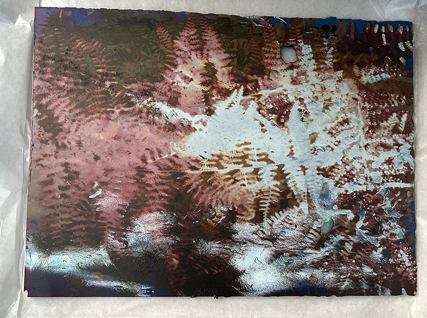

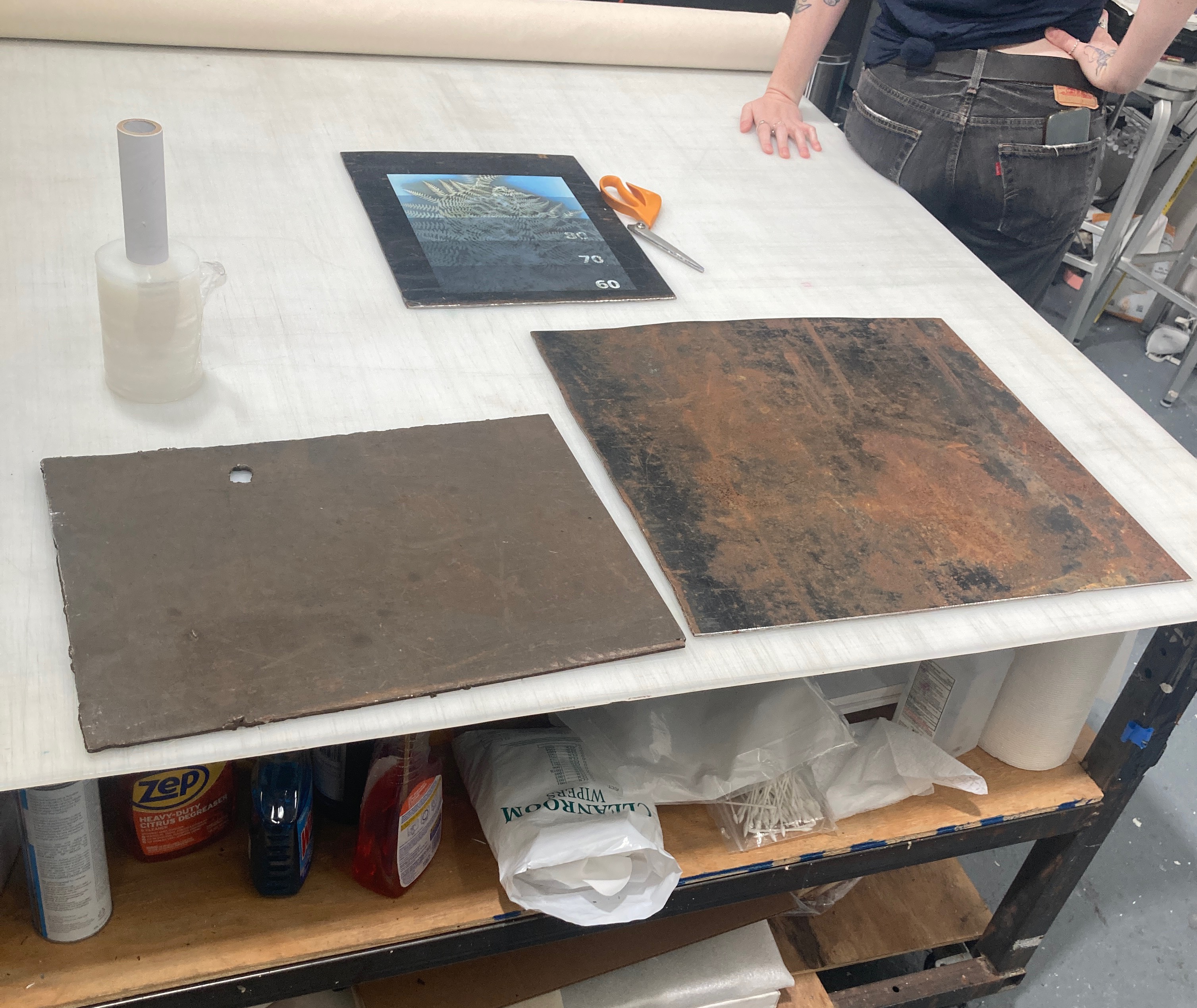

Hello everybody--and thanks to Terry for knocking on my door after all this time! This was a great thread full of comments that I still think about regularly. Regarding my lumens: the originals remain unfixed in their conservation box, and I have been using the digital scans for printing-- have been experimenting with UV printing onto steel which has been quite a year of testing and learning. I am loving the relationship between the ephemeral nature of lumens and the unyielding gravity of steel . See below the worktable at the lab, with my steel pieces and the bracketed test piece! Still not ready for exhibiton but getting closer. Thanking everyone in this thread for thinking with me.
ps. Here is one lumen printed onto the same lower left piece of steel
This process is called UV printing--where the photographic image can be printed onto almost anything I suppose, as long as it lays flat ,and is "cured" to the surface with uv rays. I am in NYC and work with a shop in Brooklyn called Color Center https://www.colorcenter.nyc/
