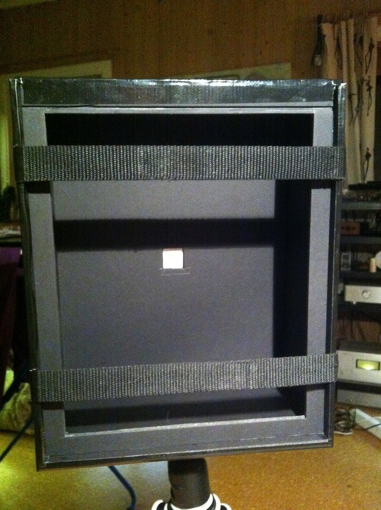

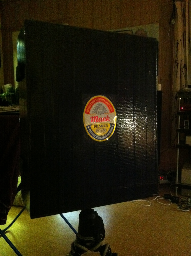

I have built a 8x10" camera of foamboard, 90mm very wide angle. Foamboard and gaffa tape are excellent materials to build around film holders.
6905068909_c7063f5e97_b.jpg 6905070401_6722c0b0ce_b.jpg 7199148626_dc0cfeef95_b.jpg
