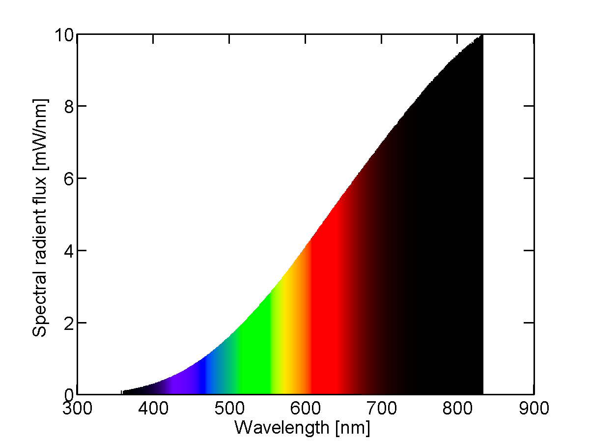

I am not an expert however I believe there is an issue with the concept of color temperature and LED lights which are not incandescent and have a different spectral shape to incandescent. This matters for VC papers which are blue green sensitive and designed for use with incandescent sources. It might be wise to include in the LED version an investigation of the behavior of the VC filters and the contrast variations that can be obtained, it may differ from significantly from the nominal Ilford values. Tests are possible before the LED lamphouse is constructed, simply lay a negative and the VC filter on the paper and illuminate it with the LED light, repeat for the set of filters, see what comes out. If it is a range of evenly spaced contrast grades with the full span of contrast from soft to hard things are good :smile:
This is an example of the spectrum of an incandescent lamp, note how blue is reduced compared to green
