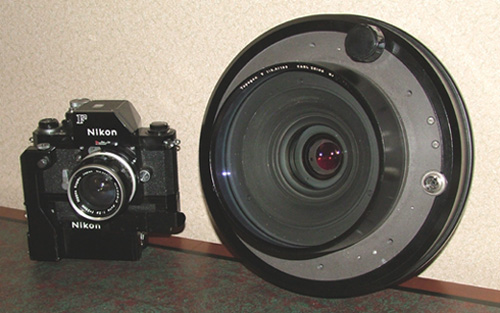

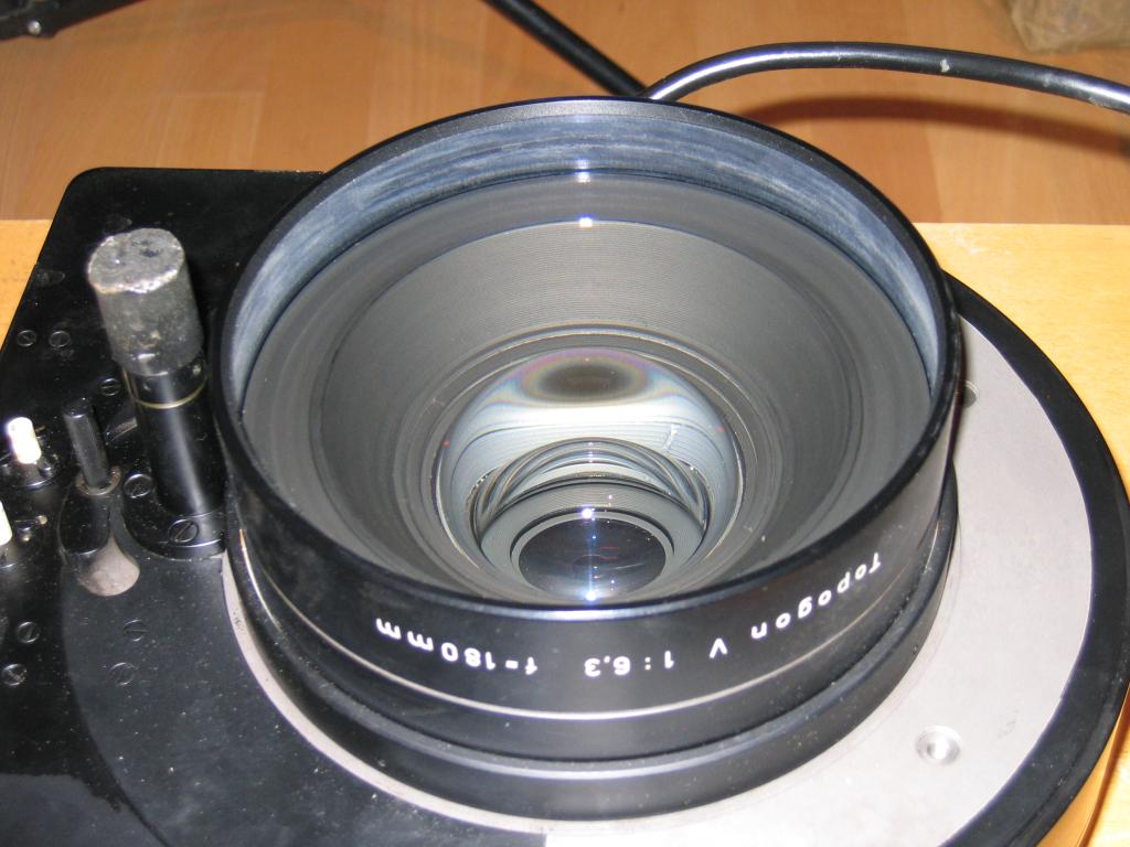

Dr Croubie, the Topogons like on the Zeiss SEG rectifier is a decent alternative.
attachment.php
attachment.php
attachment.php
attachment.php
attachment.php
attachment.php

Bob, in the 1990's I've seen a few modified Zeiss SEG 5 and some prints, that's all.
Agx explained above the main purpose of this enlarger.
