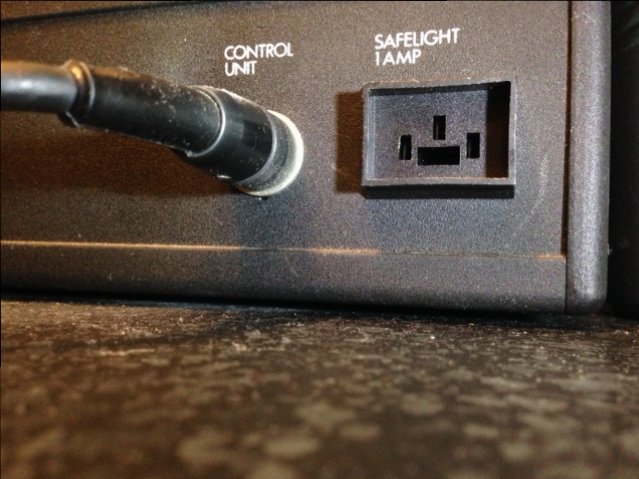

For future reference, there is picture of the safelight plug on Ilford Multigrade 500 controler
Interesting that the US version of the Multigrade 500 uses a USA standard three prong outlet and that the version you have uses a proprietary outlet. You might try contacting Ilford.

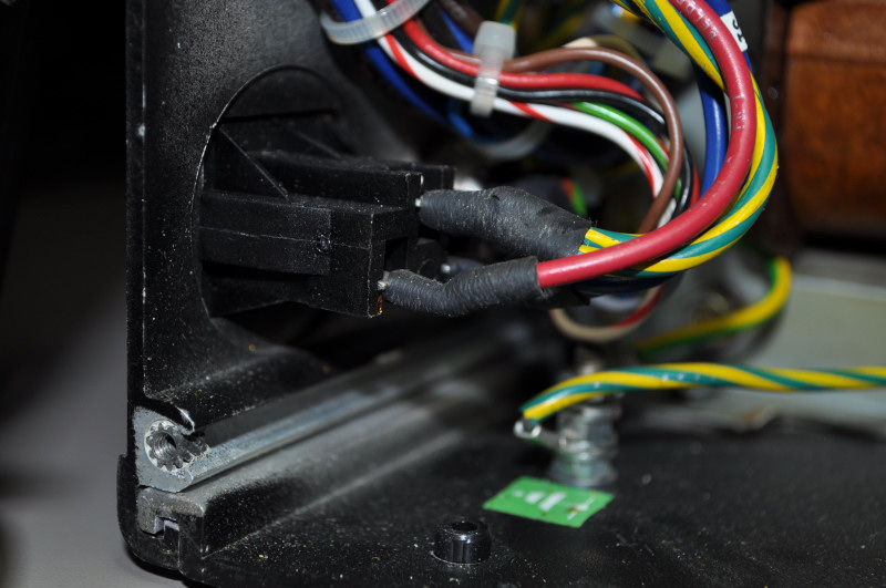

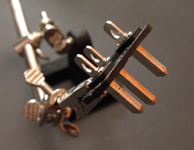

For your viewing pleasure here is the back side of the connector, wiring is a bit tight but a NA socket can be made to fit.
