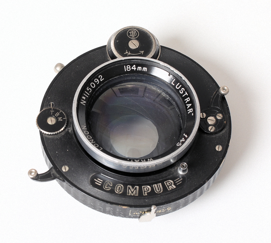

I have two more Dial set Compur II shutters, one is in th late 660 thousands the other 700074 is a Schneider lens with a serial number that's 1925/6. The SN of this shutter is offset the other way. My Wray 184mm came on an MPP monorail lens board, so presumably it was sold with a 7x5 monorail.
If you see my other thread Wray advertised this Lustrar in a Dial set Compur CII
Ian
Don't suppose it has DBP or DRP engraved anywhere?
I recall reading somewhere in an article about MPP and Wray (by Colin Glanfield?) about it supposedly not being very clear where Wray/ MPP had got their hands on the Compurs when there was a severe shortage of shutters in the UK under the export-or-die austerity conditions of the time.
The other possible conjecture I have is that they were assembled out of parts Deckel/ Gauthier had on hand as West Germany dug itself out of the wreckage and that the S/N was simply whatever was on the casings in the parts stores of what was not an especially widely used shutter size (I'd like to know the production rates compared to the #1 and the smallest Compound). The BIOS report on Deckel makes it clear that the level of destruction (and effective cessation of shutter production in 1941) was such that the shutters would need to be retooled (40-50 skilled personnel and about a year is the timescale quoted) - and given that it's probably highly likely that the decision to go to rim-set was taken at that point, I cannot see the lowest selling Compur type shutter being completely retooled twice in 5 years - as opposed to the #00, #0, #1 not going through those iterations - thus I suspect old stock/ remanufactured stock.
Or, they were 'acquired' from Voigtländer in Braunschweig as that was in the British Sector - the BIOS report on Voigtländer indicates that there were "70,000 Prontor and Compur shutters in stock, of which 40,000 are reckoned to be serviceable" - it would not surprise me if, like the Graflex metalwork on the MPP Micropress, the shutters had arrived as 'spares' or some form of CKD kit.
For whatever reason, I'd never clocked the 184 Wray as being in a Compur II, probably because all the ones I'd seen in passing were in rim-set shutters.
I've never seen a B&L dial set Compur, that shutter has the Deckel FD on the dial. Although B&L became one of the partners in Deckel, around 1910, they may have originally only made Compound shutters.
Ian
No DRP but neither to my others which are a different tube size, the Lustrar is in a 4 and my 135mm f3.5 Tessar is in a 5, as is the Schneider 16cm f4,5 Dialyte.
I borrowed an MPP MicroPress some years ago and realised quickly that the casing, shutter, bellows, front standard and focus track, were all made by Graflex. The folding front that the track-bed sits on, the back, and the Wray range finder are the only British parts. It's possible to see where the Graflex cast rack has been ground off and an MPP pair of racks attached to match a MicroTechnical pinion.
The 184mm Lustrars are quite rare in shutters, but so are the MPP 7x5 monorail cameras.
Ian

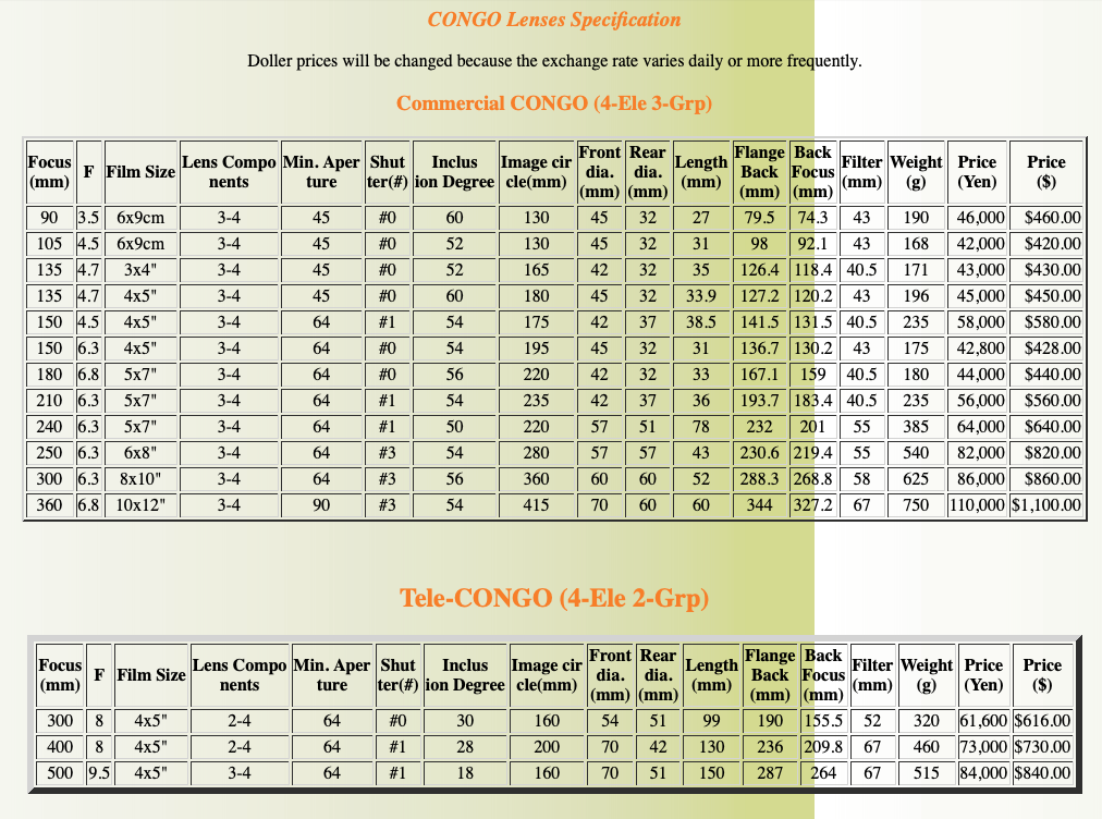

For anyone with some love to tessars, Yamasaki f/6.3 lens are good performers.
C. Congo 150/6.3 user here (Seiko, single coated).
As I understand Yamasaki made a bunch of brands for the same LF product - Congo, Osaka, Komura, Astragon, Prinz, some are unlabelled and just marked Y.O.
If anyone has experience with Yamasaki wide angle examples, especially 120mm, please share your impessions.
Prinz for sure. I once bought a 210/6.3 Prinz in Copal #1 for the shutter. After it came I asked Yamasaki whether it was one of theirs. They replied. It was.
I could well be mistaken -- recently I've been mistaken more than I like -- but I've always understood that Komura made their lenses.

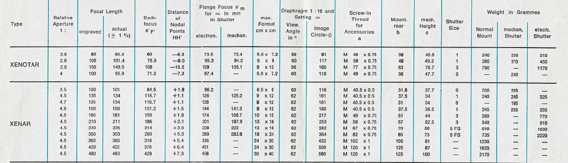

I have a Schneider Professional Lenses brochure from 1970, (I've never seen it Online) and the Compound has gone, replaced by Compur electronic shutters.
The Xenar's over 150mm were only available in a barrel or Electronic shutter, and you never see them second hand as they are useless.

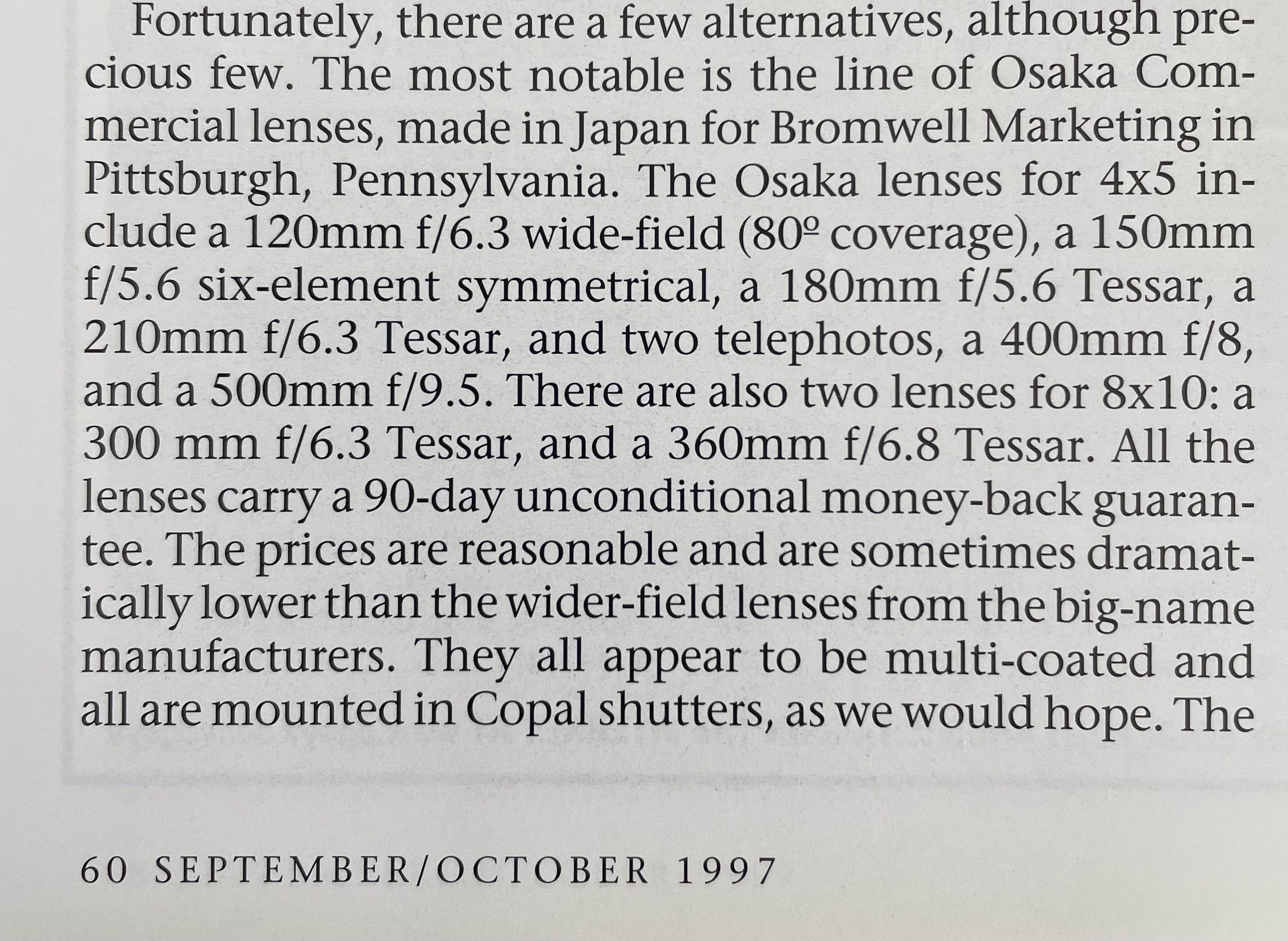

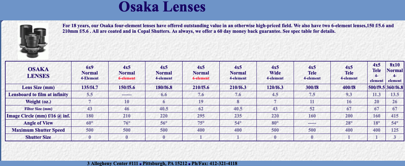

The Osaka lenses ARE Congos and they are 4-3 NOT 4-4...
From Ted Bromwell's website...
"For 18 years, our Osaka four-element lenses have offered outstanding value in an otherwise high-priced field. We also have two 6-element lenses,150 f/5.6 and 210mm f/5.6 . All are coated and in Copal Shutters. As always, we offer a 60 day money back guarantee. See spec table for details."
Compare those specifications with the ones from the other archived website...
Don't believe me? Check out this paragraph of a review of the Osaka lenses in the View Camera Magazine from 1997
