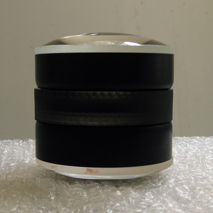

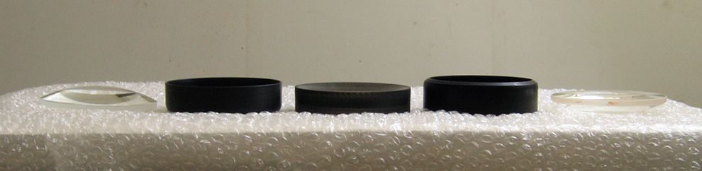

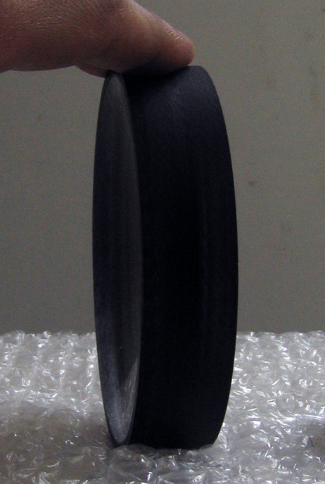

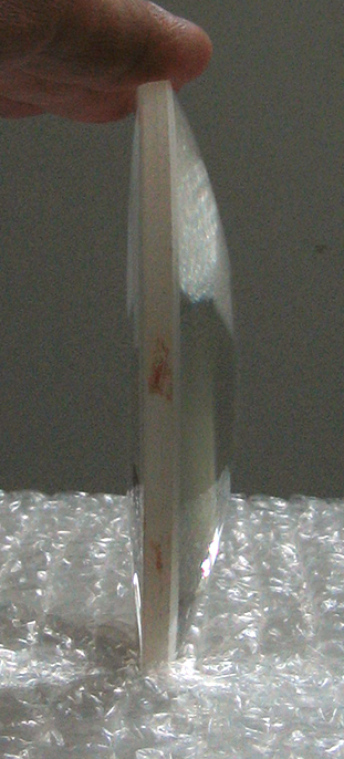

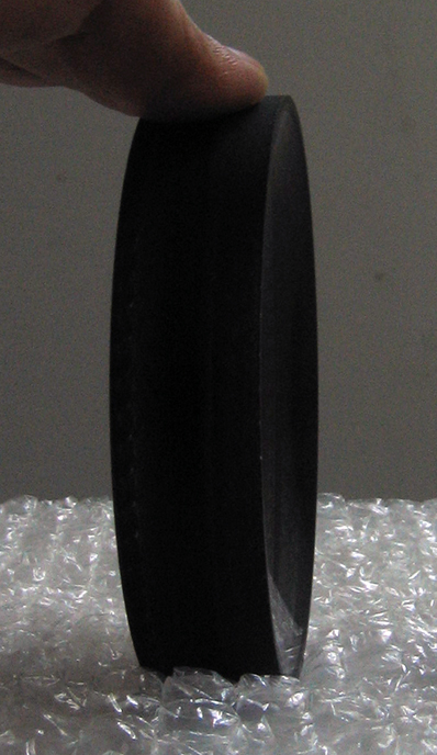

Dan, thanks for your answer. Here are the lenses I have and am thinking of tinkering with:
Left to right : front element, spacer, middle element, spacer, rear element. A little under 4" dia. elements.
Assembled in the original configuration:
...give a cca. 14-inch f4 lens (front element on top). More details of the lenses:

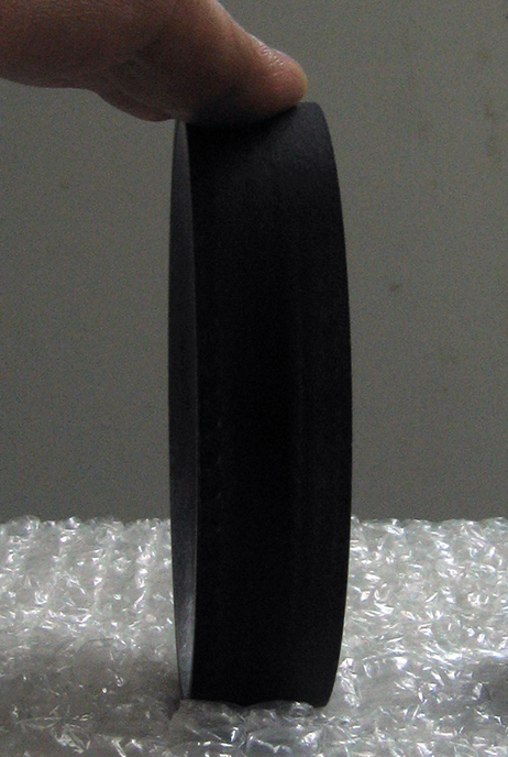

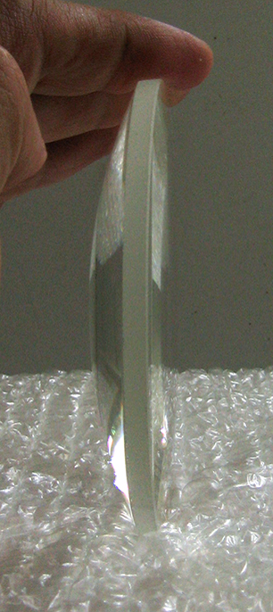

Front element:

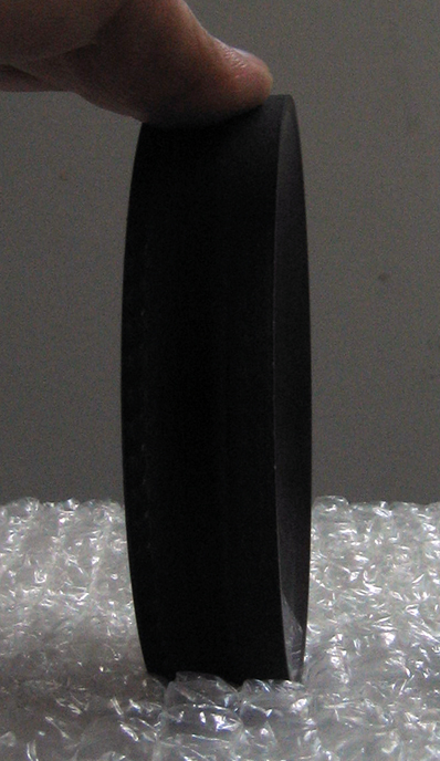

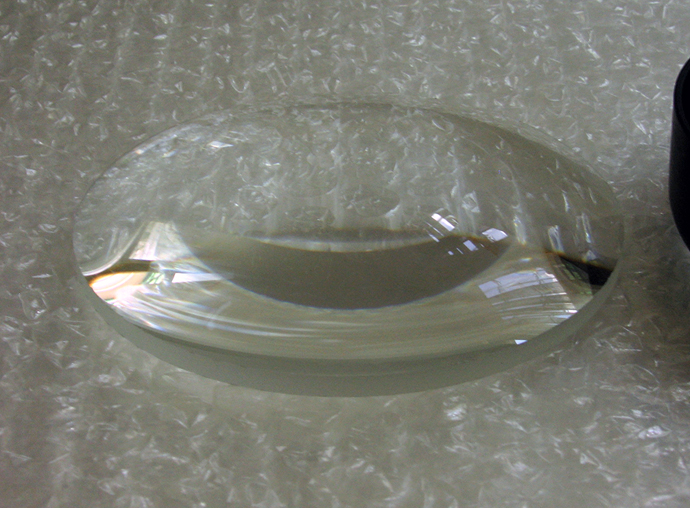

Middle element, first the front-facing surface, then the rear-facing one:
4a_middle_frontfacingsurface_1.jpg 4a_middle_frontfacingsurface_2.jpg 4b_middle_backfacingsurface_1.jpg 4b_middle_backfacingsurface_2.jpg
And the rear element:
Think it could be worth trying changing the spacing to get a 6-7" FL?
