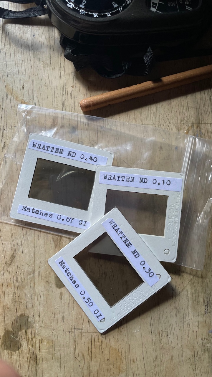

I kind of wandered away from this project because the filters aren’t cheap enough for me to cut and mail to anyone who wants them, and it was harder than I thought it would be to describe a light box that fulfills the same purpose.
Since it's just a "ballpark", there's no need to buy a Wratten 0.3 ND filter -- that you might never use again. Any 2X ND filter -- that most shutterbugs have -- will keep you in the ballpark.
Sure.
Another approach I tried was putting a box over my light box with a divider under a frosted acrylic surface (a clipboard from Office Depot) and filling one side with cotton balls until the meter reads one stop’s difference.
Also tried printing a checkerboard on overhead transparency material.
If anyone can dream up an easier way I would be interested.
