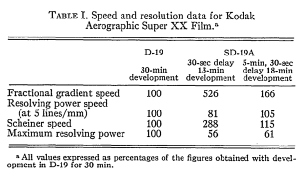

There are high-speed developers that increase fractional-gradient speeds it is not an urban legend. However, you may lose resolution, increase grain, lose dynamic range or color sensitivity...everything is a compromise. There is no X-axis on the lower chart, but I'd say it would be about 1/3 of a stop difference between HC-110(b) and T-Max (1:4) using fractional-gradient speed determination.

Call any developer speed increasing versus the developer used by manufacturer to test for ISO if that developer moves the curve to the left in the vicinity of 0.1 net density above base and fog when the film is otherwise developed to ISO parameters.

I see what you did there ic-racer!
To get a speed of 526 with that film you had to develop it 30 seconds after exposure!
So yes if you develop a film as soon as humanly possible after exposure, it's possible to get film to give more than an extra stop of speed versus normal rated speed.
Try to imagine what that might look like! Maybe a microfilm or high-speed camera built in conjunction with a developing system that develops the film as soon as it passes the exposing gate.
