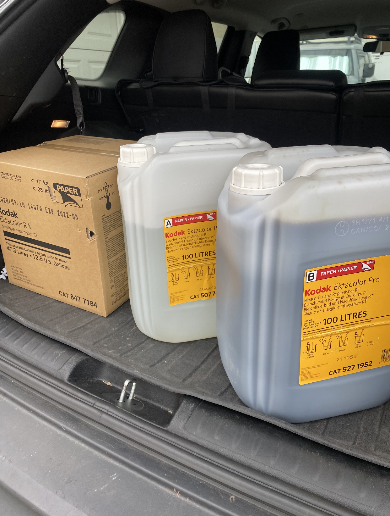

Sorry, i think it may actually yield 25gal. It appears the actual contents of the RA Developer Replenisher is 12.5gal. (see attached).
I basically either need to figure out the best way to keep this stuff stored properly so I can extend the life of it for as long as possible (or) I need to return it within 30 days to get my money back.
Obviously since it’s so hard to get this stuff right now & i’d love to make it work, whether that best practice is keeping it as concentrate & using as needed (or) pre-mixing everything & portioning out into glass bottles (air tight, etc.)
All in all this put me back a few hundred $USD so I really just want to make the right decision here. After all, what good is having the chemistry if the chemistry is no good…after a short window of time.
Seeing how I would be most likely doing 1/2 day sessions using a drum processor & not huge high volume print production, I just want to be realistic.

With that much, you might try decanting the developer components, most importantly the developing agent (part B) into smaller full glass bottles, but It is unpredictable how long the developing agent will last after this. Then use them up one at a time, mixing up whatever amount that will make and storing in full bottles.
The other choice is to mix it all up at once, a lot to mix and store, but will give the longest overall life.

precip
The clear solution of the blix is the fixer part of the blix. This part, the clear fixer part is sensitive to oxygen. Left open or exposed to oxygen it can precipitate out sulfur and end up a stinky ruined mess. I have kept the clear portion of RA4 blix stored for years in absolutely full, no air, HDPE bottles. I have used Gatorade bottles, glass bottles etc. I have found the dark reddish brown, bleach part of blix to keep well in the original bottle for years.
Developer Replenisher concentrate should be stored in absolutely full bottles, I would use the same plastic type as what was used by the manufacturer. Some plastics like PET are embrittled by alkali solutions. Try not aerate the solutions when decanting.
