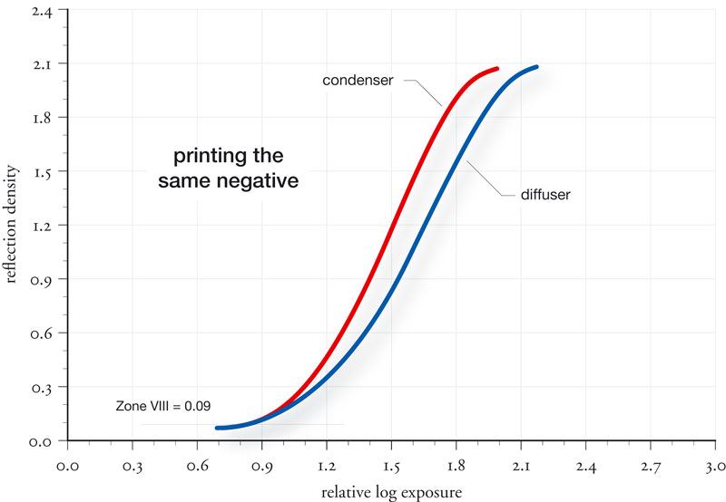

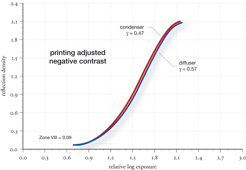

David
Dr. Richard Henry did that for his book 'Controls in Black and White Photography', and I repeated it with more modern materials. I got the same results as he did; no difference between diffuser and condenser enlarger as long as the negative is developed accordingly.

Actually, that shows something different from what I'm thinking about. Your graph shows that you can match print densities by developing the negative accordingly, and I don't dispute that, but I'm asking whether the sharpness of highlights is different due to the light scatter in areas of higher density of the neg and the way they are rendered using a condenser enlarger as opposed to a diffusion enlarger. Of course if the contrast is matched, the highlights need to be even more dense for a diffusion light source, and beyond that diffusion light sources are all about light scatter, but maybe a more precise question would be: is the difference in sharpness between highlights and shadows for prints made with a condenser enlarger different from the difference in sharpness between highlights and shadows for prints made with a diffusion enlarger.
It's kind of an academic question, because I don't think this is a thing that anyone tries to control in practice, but an answer might add to what we generally understand about the difference in the way prints made using a condenser light source look when compared with prints made with a cold light head.
