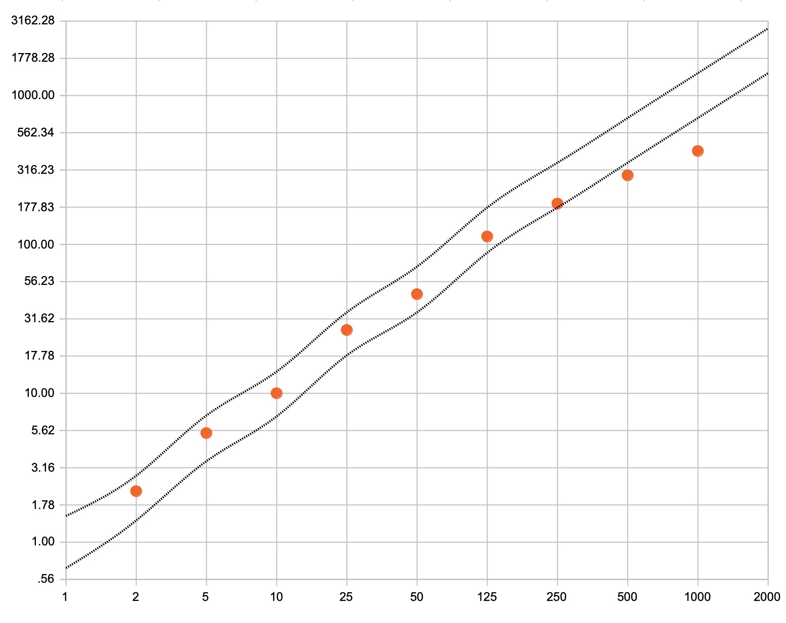

Hi, I too have a Kiev 4. I find the shutter speed pretty difficult to judge by ear. I recall seeing someplace on the internet a shutter time measurement method based on taking photos of a target on an LP player. Costs nothing to try, if you have one. I have a pretty good timing setup using a laser, photodetector, and scope. It lets me selectively look around the shutter and see if exposure is even across the field. Anyways, I have had mixed results attempting so service my own cameras and am usually content to map the true shutter speeds and put a sticker on the camera so I can expose accordingly.
Here's the time data (assuming the upload works, first post for me here) for my 1976 Kiev4AM. Pretty good except it falls off at the high end. The dotted lines are +/- .5 stops.
