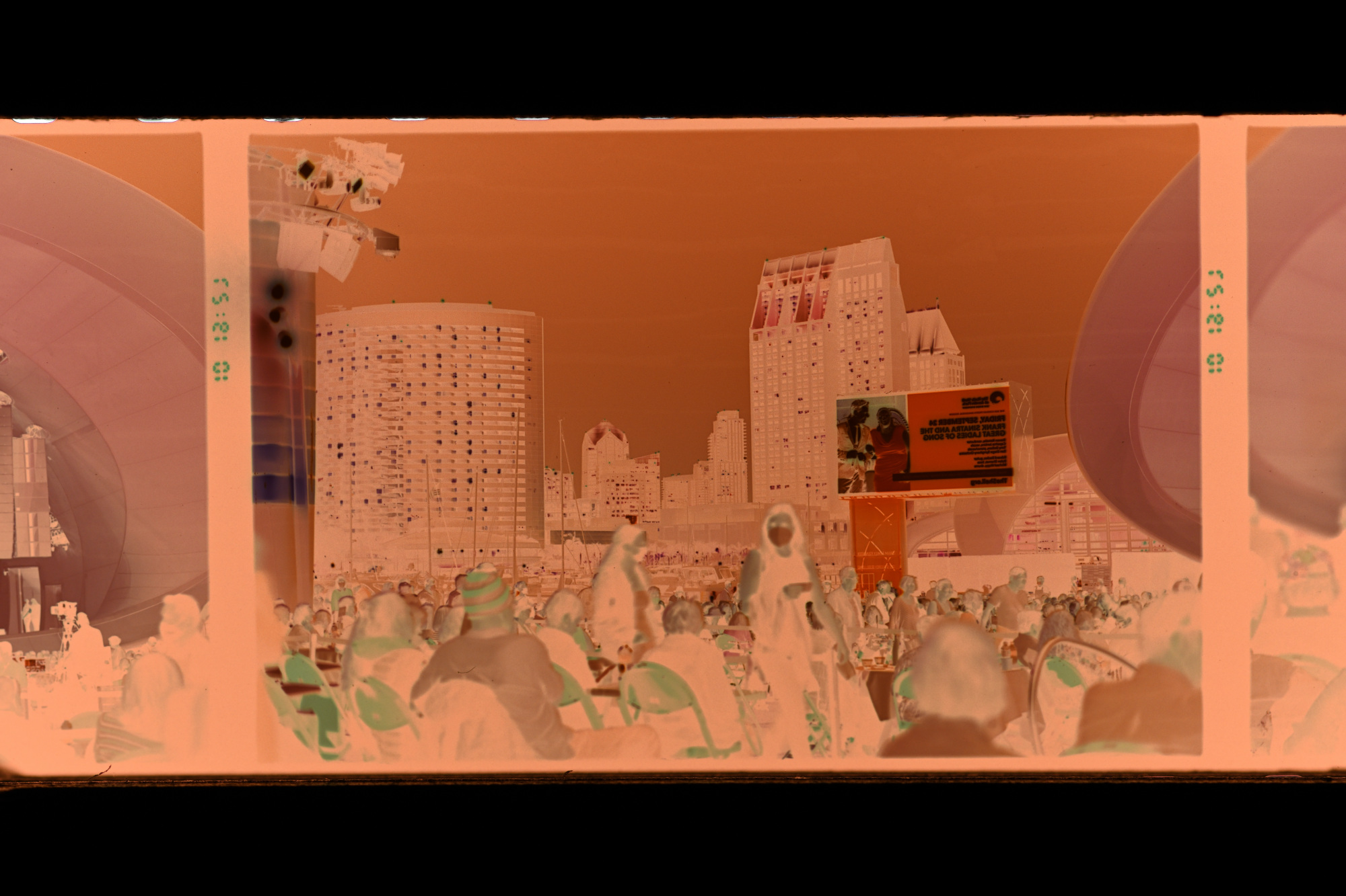

Sorry for the delay. The clouds cleared away and the moon looked photoworthy, so I had the digital camera out.
Here's a quick shot of the neg:
Thank you for posting the image of the neg. I can see the lines clearly.
And they appear to continue into the frames on either side of the negative image posted.
Without seeing the negative in person, I would guess that they look like drying marks.
Can you rewash and dry the negative strip and see does it remain the same?
