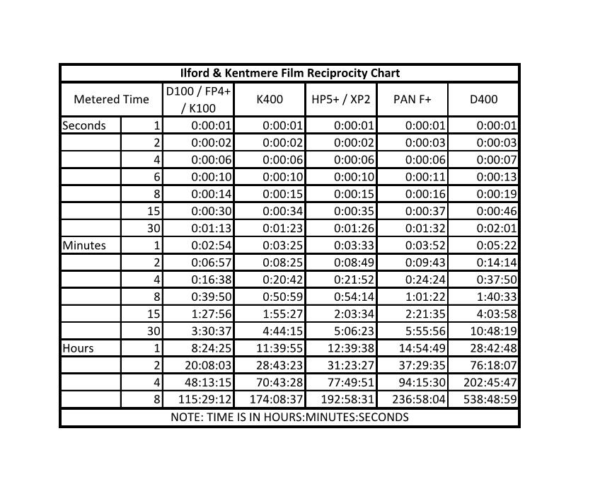

Here is a chart I made up for most Ilford films based on the new reciprocity numbers they provide for night photography. It's easier to carry the chart than to have to pull my phone out to do the math on a cold night. So far It's worked well for me. Delta 3200 should have been grouped with Pan F and I forgot to add SFX on there when I made it up. At some point I'll make those correction.
Edit: If you are using a filter the Metered time in the chart would be the actual metered time + your filter. As said I made this with night photography in mind.
