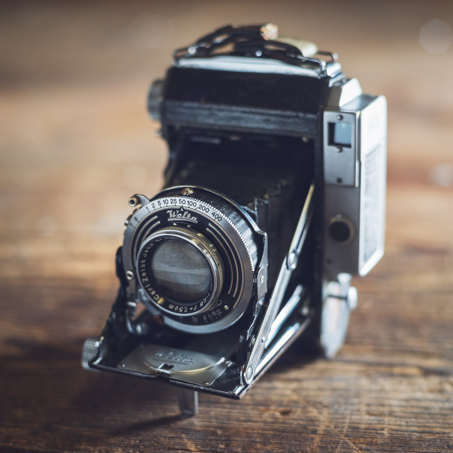

So a buddy picked up an old 1930s Welta folding rangefinder with a Zeiss 2.8 and Compur Rapid shutter. He gave me an RB67 kit in return for bringing the Welta back to life. I know. Good deal.
But I've tried nearly every solvent I can find to clear up that escapement, and it's still sticking. Lighter fluid, 91% alcohol, a rifle bore cleaner called Butches Bore Shine, carb cleaner, starting fluid, etc. A whole lot of soaking and a whole lot of flushing. She still hangs up on 1/5, 1/2, and 1 sec.

Really appreciate all the info here. Got a chance to adjust the main tension spring on the cocking lever, lubricate the different areas within the speed escapement and a couple small friction points within other parts of the shutter. Today she's running like a champ. I haven't timed the speeds, but they don't hang up and sound close.
That's good to hear. She's a beauty!
