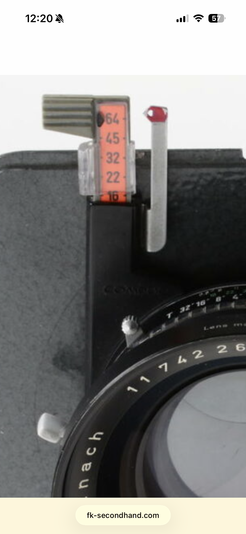

Hi, Ive got the lens on compur electronic shutter that has lever on the top? Is it possibile to remove those leveres? They make the lens more bulky to trasport.
Anyone know what is the purpose of these levers?
P.s. Where I can get battery cover for the shutter?
Yes, its part of an auto aperture system. Not all Compur shutters have it. The parts are just screwed to the shutter and board..
Stare at it long enough, and removal will become apparent. Without seening the entire board fron & back, its hard to offer more information, but its also possible you may need a new lens board. If so, look for a Sinar top hat board for a #3 shutter. That could add up to 20mm extension.
