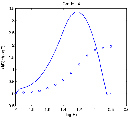

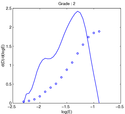

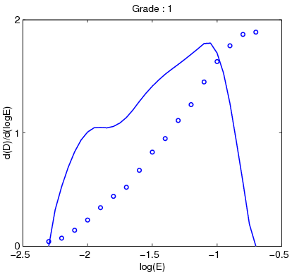

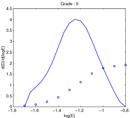

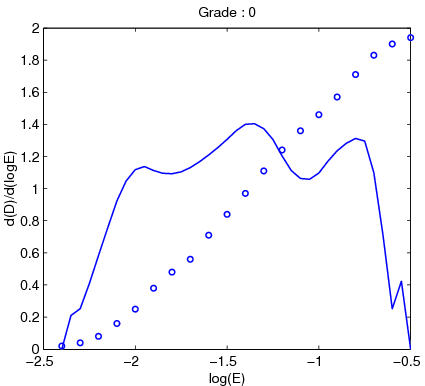

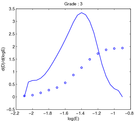

I suppose you mean the derivative (slope). That is where I reap the benefit of having fitted the measurements with a spline: straightforward (leaving aside the details of programming) to compute the derivative/slope. So there you are. My curves are not as pretty as those of http://www.darkroomautomation.com/support/appnotevcworkings.pdf His curves are entirely made up in the computer, and according to the point he is trying to push ; moreover they are disconnected from reality; e.g. in the real world there is no plateau in the middle of the Grade 0 D-logE curve.
The little wiggles in the curves below are not significant. What do we have?
  • Grade 0: constant slope (except of course slope drops to zero at both ends)
  • Grade 5: slope peaking in the middle; i.e. an S-shaped curve (often introduced in d*****l processing to add "snap" to the midtones)
  • In-between: slope generally rising from dark to light tones and peaking around D=1.5 (darkish gray) (always zero at ends, of course).
Thank you so much, I guessed that it is easy for you to generate such graphs :wink: I really meant the difference (aka change) of the derivate but these graphs are already so good - the change is already visible / grade 1 & 2 bumps are now more visible. I wish all papers had such graphs too :smile:
If you still want to generate a derivate change graph, please plot all grades on same picture too :smile:
