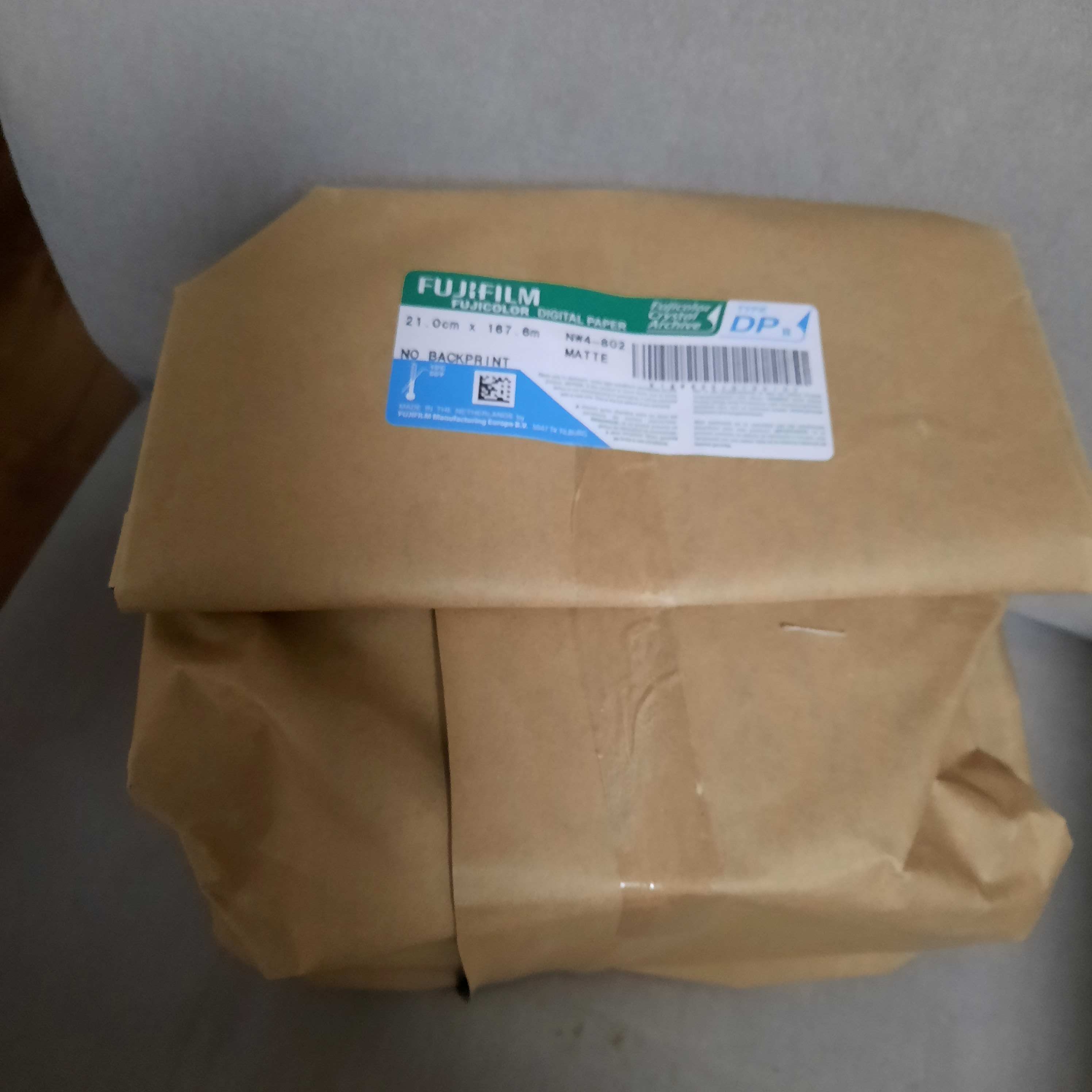

By the way, I am just starting to cut this in sheets, to be put in my freezer. It is a 21cm x 167-6m roll of DP II. Should last for some time.
