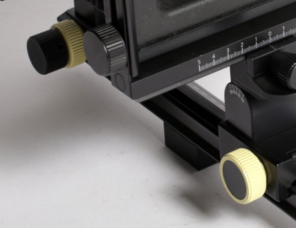

The Arca Swiss F does seem next level. I found an affordable one on eBay but even though it’s listed as an “F” I suspect it’s actually an Arca Swiss Discovery. Not a bad camera but not the same thing.
I’ve been absorbing the advice here and looking at options online. Arca Swiss is very pricy indeed. Objectively I don’t think the prices are excessive (compared to a bag of groceries) but I’m also seeing loads and loads of used Sinar F/ F2 cameras with standard & wide bellows for about the same price as an Arca Swiss bellows! As a longtime owner of a Sinar, I’m well aware of its strengths and limitations but at those prices it might be worth it as a second, horses for courses camera.
Or just sell the DLC, supplement a modest cost differential, buy a TK 45s, and be happy!
Discoverys are easy to tell. Shift on an F-Classic is a pinch clamp--squeeze the clamp and the standard loosens and you can slide it back and forth. Discoverys have a screw knob to loosen/tighten the shift clamp. Discoversy also do not have geared focusing on the front carrier.
F-Classic Shift pinch clamp:
Discovery Shift Clamp:
For focusing on a discovery you can see the front standard only has "lock" whilke the rear standard has lock and focus:
I don't know if it is all of them, but the Discoverys I've seen have some yellow knobs. The F-Classic (and F-Metric) are all black and grey.
Ther than that they are basically the same camera.
