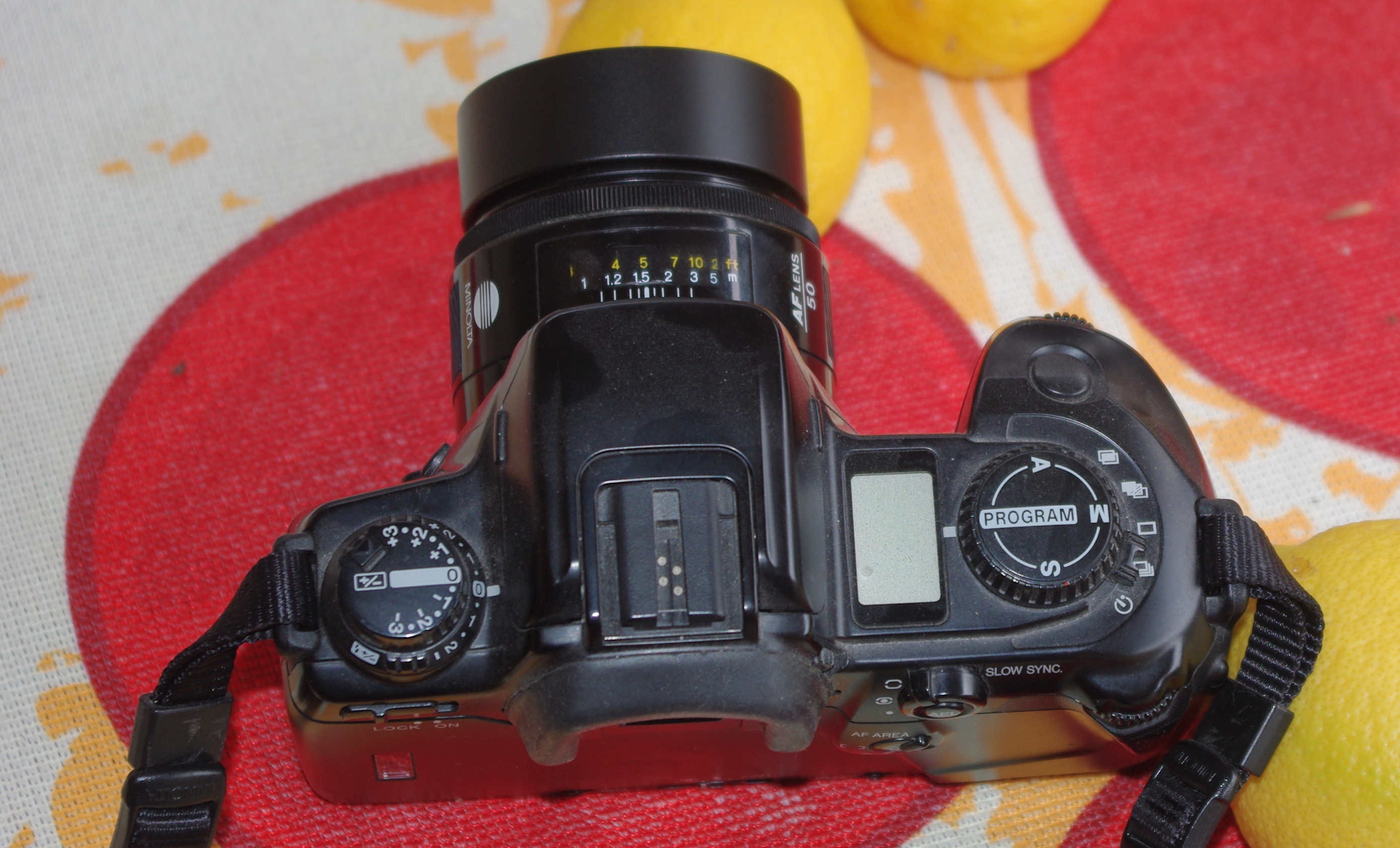

In the US you can get a Minolta 600si for less than $50.00, don't what they run in Germany. Attached is an picture of the 600 with a 50mm lens, you can the large compensation dial on the left.
